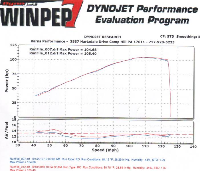

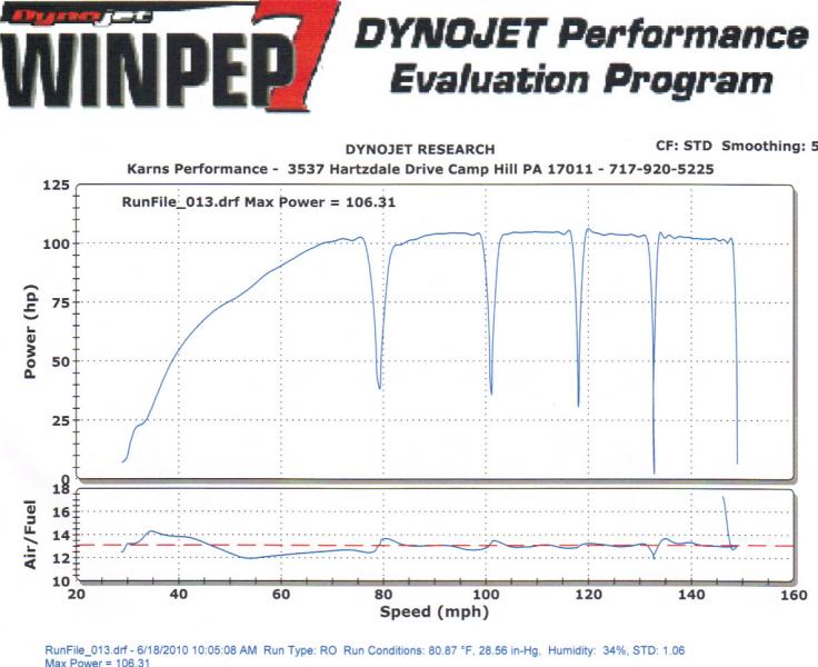

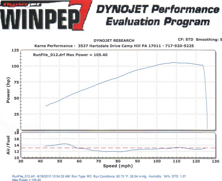

Ok guys. Here are the latest dyno graphs. As can be seen in the comparison graph, I got rid of much of the richness in the mid and upper range, but got slightly leaner at the very bottom. The dyno tech said that is about as close as I will get it. When I asked him about the lean spot he said it was of no importance. He went on to say that lean spot was produced at full throttle at 3k rpm and no one rides like that. I see his point, but is he right, or just tired of giving me free pulls on the dyno? Haha. As can be seen, it's a little leaner in that area on all the graphs, but it seems so miniscule, especially when you look at how much of that richness I got rid of. Like I said before, the bike feels fantastic, but if you guys think I need some tweaks let me know. Thanks all.
He's part right at least... It's at 14.5 ish A/F... That's not "Lean" as in terribly lean and will cause a problem... It's definetly more towards lean than ideal though...
And yeah, he's mostly right about the "you don't ride that way"... I very rarely goe to WOT at 3k... I mostly roll on a bit more subtle since I prefer to be on top of the bike, not the other way around... But on a V2 vs IL4 note... But yeah, an IL4 guy won't roll on to WOT at 3k because that will only cause his bike to sputter... Not sit on it's **** like a VTR does...
I still think it's on the rich side in the middle, but definetly getting there...
It doesn't need tweaks... But I'd probably make a few more attempts...

Thanks Tweety. What should I change? I know from expeirence that if I go down on the needles, I will be too lean, so that limits what I can change. Maybe 50 pilots and take mixture screws out to maybe 2.75 or 3? My reasoning is that with the bigger pilots I could get away with dropping the needles to 3rd from top. Oh and just a refresher, my setup is as follows
175/180 mains
48 pilots
needles: 4th from top
mixture screws: 2.25 out
OEM filter
Thanks

IIRC you tried 2.5 turns out and it was too much - correct. If that is the case then 50pj would be too much as well. Did you try clip 5?
I do not have easy access to a dyno, my butt is my dyno, so at this point I would be out riding with a smile on my face, and maybe my butt too
JB

I'd leave well enough alone. You never mentioned (that I saw) your elevation... You've been chasing your tail a bit, and the dyno operator is right...it's pretty darned good. Remember that a CV carb is a compromise at best...your needles are moving with the slides as dictated by intake vacuum. Not all needle tapers are ideal, and at cruise you are running mostly on idle circuit plus a certain percentage of metered main (which is what the needle is doing). VTR's are happiest a scosche rich. I have chased my tail and even half clip movements on my factorypro kit can really change things a lot. I live in Seattle at sea-level, but when I take long road trips into the mountains, I am always stinky rich there. You readjust needles for that, and suddenly you have lean surges at cruise...it's a crap shoot.
This is the kind of thing that makes me strongly consider flo-commander. When I take my ride this summer down the California coast and up into the mountains, I may do 6-7k feet of elevation change in a few hours...when really the bike is only happy at ONE elevation (the one you jet it for).
Tune for RIDEABILITY rather than a magic dotted red line on the dyno sheet. You were getting FANTASTIC mileage out of that thing before and said your were pretty happy with the way it ran. That would be enough for me
-R
175/180 mains
48 pilots
OEM filter
Thanks
Sorry... Experience doesn't count unless it's been on the dyno that exact way...
I agree with residentg... Possibly try the needle one clip setting in each direction... The thing is, if you swap that, you don't even need a dyno run to put it back to the way it is now... You know how to do all that... Right?
But the easiest thing to do, that you can actually do between runs on a dyno if you have the needed tool is to try 2 turns, 2.25 turns, 2,5 turns and see what the results are... Adding a quarter of a turn to the mixture screws is a 30 second job if you have the tools and have done it before... Go get yourself an angle head bits screwdriver...
wyldryce has a valid point, but he's probably missed the bit about free dyno runs, I would most definetly do the mixture screw experiment...
