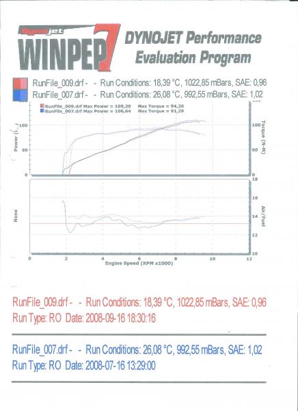

BTW to reference what I was talking about earlier... Compare this to your previous dynorun... Please note it's not mine, it's from a member on the Swedish forum and very much work in progress for him too...
Look at the A/F... The first run was decent... The second is better but still not perfect... It's just on the lean side of perfect... But it gives a nice contrast to your A/F ratio with a decidedly rich middle...
