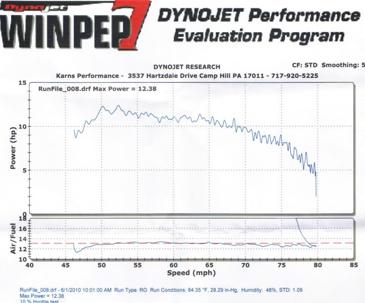

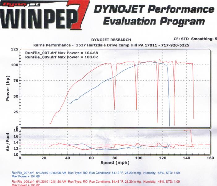

Ok guys, so here are my dyno charts. I am pleased to see I picked up the horsepower I was looking for, however, the guy at the shop says I'm too rich. Unless I'm interpreting the charts wrong, I think I am lean. They did a 3rd gear roll on, a 10% throttle test, and ran through all 6 gears. Let me know what you guys think. Maybe it's time to switch to those 48 pilots as residentg suggested. The shop says turn the pilots out more and bring the needles down to 4th groove. I'm knida stumped. The bike pulls strong from idle to redline. I just want to ensure i'm tuned optimally. For those of you who havent read/forgot my settings here they are:
180 front
185 rear
45 pilots
needles 5th groove
pilot screw 2.5 turns out
Any advice is much appreciated. Thanks guys!!
Attached Thumbnails i need a lesson in jetting-dyno-1.jpg   i need a lesson in jetting-10%25-throttle.jpg   i need a lesson in jetting-dyno-3.jpg

I'm no dyno chart expert, but it looks like it could be runnin a little lean to me, but prolly not bad enough to change anything as long as it pulls hard all the way to redline I don't think I'd change much...

Actually the dyno guy is right... The higher the number the leaner... Ie you are at or below 13 at all times... I'd say he isn't that far off on his recommendations... A pair of 48's with a change on the needle would look nice in that graph...
To simplify a little, that red line there is at 13... I'd like that too be "midline" in your AF graph... Then you'd be making about the same power as now, and not wasting a lot of fuel... Because that midrange dip is definetly rich...

Thanks tweety. Guess I was reading it wrong. I thought thst below the red dotted line was lean.

The red dotted line is whatever you want it to be, i.e. whatever the tech is shooting for. I4's tend to run most power with a slightly leaner mixture, probably because the cylinders are smaller and you get better combustion. The twins like to be around a 12.5 ratio. So, in looking at your graphs, I'd say that the tech is spot on. You need to lower the needle a notch, your mains are perfect, and as long as it idles smoothly then your mixture and idle settings are good. BTW, you say 5th notch, but 5th notch from what? Top or bottom? Needle position highest or lowest?
[Edit] Looking at it again, you might be able to get a little more power by going one bigger on the mains, but it's based on your elevation too. You could play around with it to get the best top end power if you wanted to.

Like Hawkrider said, that line is setup as a "target" by the operator... On your graph it's set at 13... And in the middle there you are down to 11'ish... Like said, you will get a few dips below the line and a few small hills above... But if you try to even things out around that line, somewhere between 12-13 is where the hawk makes loads of power, a bit different from bike to bike where you end up... If you have the AF there where you need it in the revband, and around there through it all, it makes all the difference... But perfect is impossible...
BTW, thinking this through a second time I realize I could just have said "I agree with Hawkrider"... I'm not adding much of anything new...
Just one tidbit... Don't go staring at the numbers I post, or Hawkrider or anyone else post... 12.5 AF works good... So does 12.7... Or 13... None of it is set in stone... You will find a setup that gives your bike a "smooth" line on AF as well as torque/hp... And when you find that sweet spot which gives you small, smooth swings all over the revband it will give you the best possible result for your bike... But when the AF is going up or down in a specific area like that, it means you can improve on the setup...
