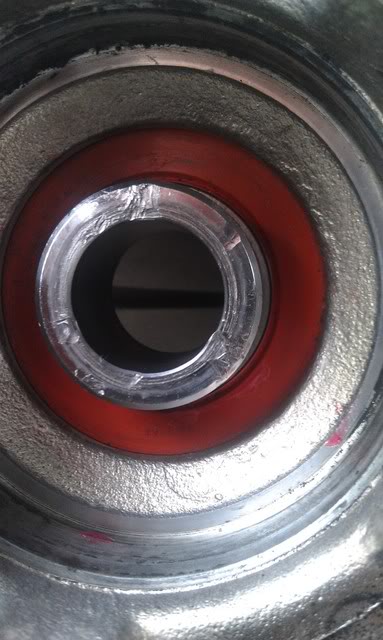

A little backstory:
First took the wheel off...figured shoot, I don't wanna f**k something up trying to pound these out. So I found an MC shop down the street. They pounded the first two bearings out easily. The large one, in the drive gear asmy or w/e, he couldn't get out...just tried to whack the collar with a hammer and socket extension. I watched him, cringing, but figured, hey: he knows what he's doing, right? LOL so I get it all back together, an install the bearings myself. This is what I found after I thought outside the box:

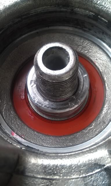

See that defamation? THATS what was pinching the f**king axle!!!! Here's another, showing the axle being caught:
See the shoulder of the axle thread getting caught??? Mother f**Ker...
So there I have it. Problem solved!! And as for the fan issue..it was a faulty thermo switch...got it on order from Ron in NC LOL
