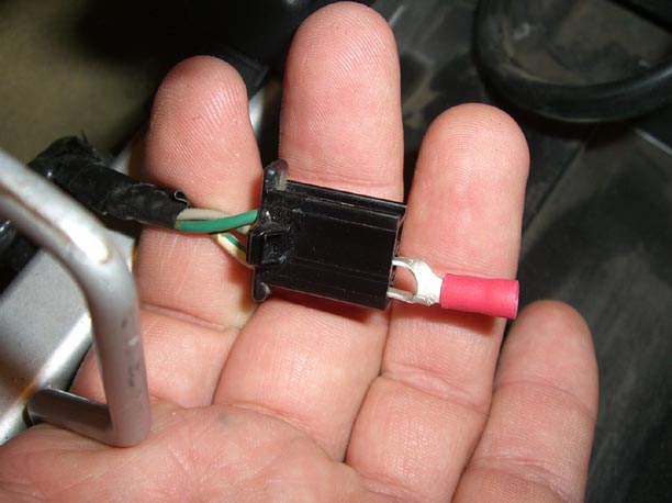

Yes the FR-3303 is the flasher relay. If you want to test the switch, you can try this:
1) Ignition off, key out
2) Unhook the connector from the relay. You'll need a jumper to hook the grey wire and the white/green wire together. (a bent spade connector works well)
3) Make sure you don't have the jumper touch the green wire or any metal on the bike or you'll get a short
4) Turn the ignition on (you don't need to start the bike)
5) Pushing the turn signal switch should give a steady on for your signals. If it doesn't, then your switch needs attention. If the signal lights work, it's your relay.
6) Don't leave the turn signal on too long, just a couple seconds to avoid heat build-up.
I've thought about this a little and wanted to add a warning. If the switch is bad, like a grounding issue, there is a possibility of melting a wire. If you do want to test the turn switch, you should temporarily change the 10amp brake/turn fuse to a smaller one like a 3 amp.

Thank you, it definitely sounds like the flasher relay has gone bad. However I will try jumping those two wires just to further troubleshoot it before I buy any parts that I may or may not need. I really appreciate all of your help and advice. This site is awesome.
