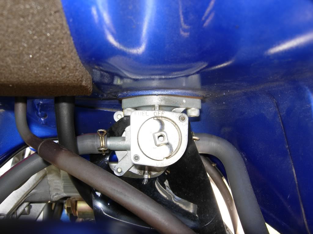

Everything should look like this:

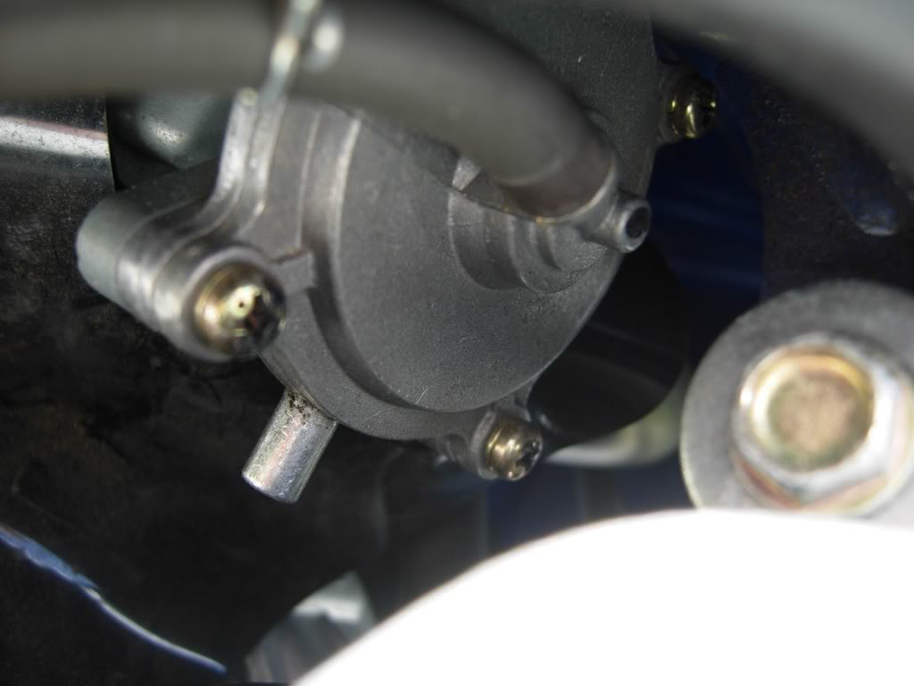

And this from the back:

Well, I have not figured out what "PVLIR" stands for but I know what it means. It means that I missed connecting the 5th hose to the rear of the petcock. The Drew C14's attached photo helped. As it turns out, I also photo'd the undertank before disconnecting all hoses. My digicam is old and has only a 1.5" display and I missed this hose when reviewing that display. When I downloaded photos to laptop and then zoomed in on the petcock I could also see the 5th hose.
Thanks for the help, "Old Yeller" is running fine. OH, what does PVLIR stand for?
