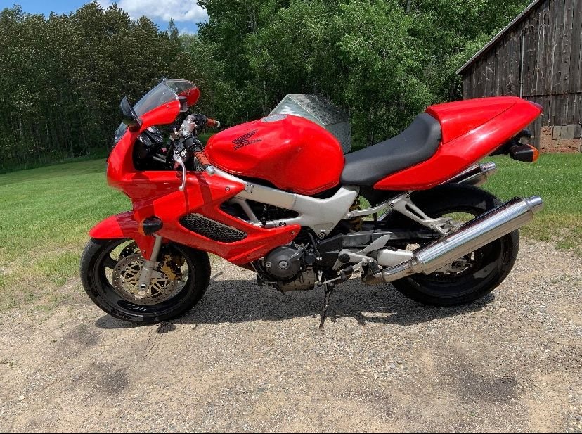

I bought a 98 Hawk. The PO has it for the past 17 years and the bike seems to be in pretty great shape overall but he lived in northern Michigan and was riding country roads, my test drive was great but I was also riding those same roads and highways. I brought the bike home and took it for a ride today, I live in the city and I really didn’t like the ride.
Does anyone know what the factory gearing is? Or have any recommendations on what I could look into to doing lower it to make it better for getting around town? As of now I have to stay in first to make it through the neighborhood. Any advice would be greatly appreciated
1998 Honda VTR 1000 Superhawk 30k

16-41 is stock. Some say 16-43 is the sweet spot. I think Mr Marquez runs 15-43. How low do you want to go?
I'm sure others will provide direct input for city riding.

16-43 is where it @ for me. W/ a 15, you really loose top end and first is almost useless IMO.

Thank you guys for the quick replies. I was thinking if I added a couple teeth to the rear It would be better. I got my plates today and actually went for a decent ride. I wish I would have researched the bike a little more before I bought it, but it mine now and ultimately I would like to keep it. It seems like the issues I am experiencing are quite common. I thought It was running a little hot when I rode yesterday, but I was only in the neighborhood and from what I read if you go slow it gets hot lol. If I stay on roads where the speed limit is above 35 then it seems to run amazing. If I am in the neighborhood or have to stay 30 mph or less it get pretty warm quickly and even stalls out on occasion. I think I need to take her out a few more times to make sure it isn’t me, which I only think it could be because the stalling is getting better as I get more comfortable and learn the bike.
I changed the oil yesterday because the frame was getting hot to the touch and I read that they can be very sensitive with old oil in them. It actually seemed to cool it down quite a bit, the frame still was warm but nowhere near like it was the day before. I used Mobil 1 15-50 and a super tech filter. I am going to order a new radiator cap, flush the cooling system and chase the air out just to be sure. Supposedly it has a K&N air filter on it and that could be part of the stalling. I have a number of things to check out. I am hoping it is something simple, it might be running a little rich, cracked hose, fuel petcock, carbs cleaned or synced.....all this forum reading makes me think I should get the MCCTs installed as well. I would like to wait until winter if I am going to do that.
