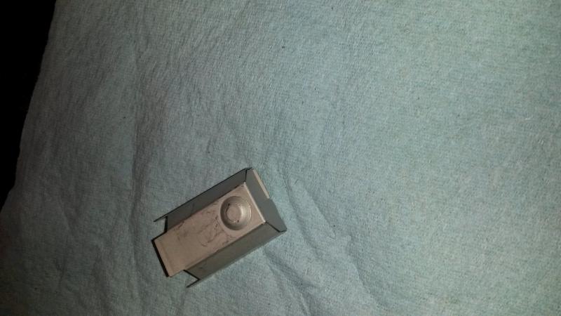

I had something clanking in my tank. It was a metal part of the sender unit guess its some kind of a cover for the sender wiper. Not sure how or why it came loose.
I was able to get it out but turning the tank upside down and then tilting it forward to get the piece up into the shallow part of the tank. With the tank up on its front edge I used one of those extendable magnet pick up tools and was able to get it out.
Pic is the piece I'm talking about.

Yes, don't bring this to a pro for nothing. Remove the back plate with the sensor attached to it, and pull it out. You will then be able to assess what's loose in there. It will also be much easier to get it out through the back plate hole.
Old Mar 9, 2015 | 08:35 AM
Posts: 1,997
IIRC the original stock sensor has a sheet metal plate attached with a couple of fasteners. The new stock parts do not have this plate. As Jack said pull the sensor out from the bottom of the tank. you should be able to fish the loose part out if it has come detached completely from the sensor. If I were you I would replace the sensor now as the tend to go bad with age. Plan on replacing the O ring seal while your in there. Also make sure you put the petcock vac line back on wrong nipple so you can come back and post about how the bike doesn't run.
