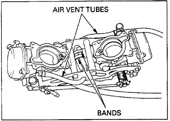

Gas line
Where does this line go to that's in between the carbs
Old Jun 3, 2020 | 01:40 PM
Cadbury64's Avatar
VTR virgin
Joined: Mar 2015
Posts: 447
From: Auckland, New Zealand
Those are carb air vent tubes, they are meant to be just where they are.

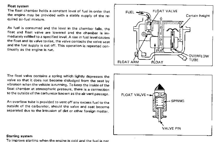

Thats what i thought but the one on the left when I try to start the bike it leaks so thats why im asking. Any help would be much appreciated
Old Jun 3, 2020 | 02:33 PM
Cadbury64's Avatar
VTR virgin
Joined: Mar 2015
Posts: 447
If fuel is coming out from the air vent then the carb is over-filling. Fuel flows by gravity from the fuel tank/petcock into the carb by way of the float valve. The float valve floats up and shuts off the fuel when the right level has been achieved in the float bowl, just like the ballcock in a toilet cistern. The overflow you are seeing t means the float needle is not sealing, which could be a worn needle or seat or a bit of debris stuck in the valve. Sometimes tapping the carbs gently will dislodge a bit of crud and help it seal, but its probably best to remove the carbs and the float bowl for a good inspection/clean out. With the bowl off, you can just slide the float pivot pin out and lift the float and float needle out for a look/clean. The diagram is from the common service manual so you know what I'm on about.
