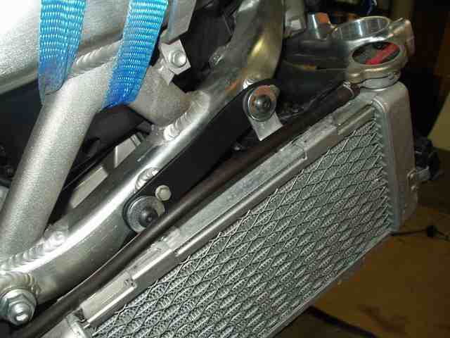

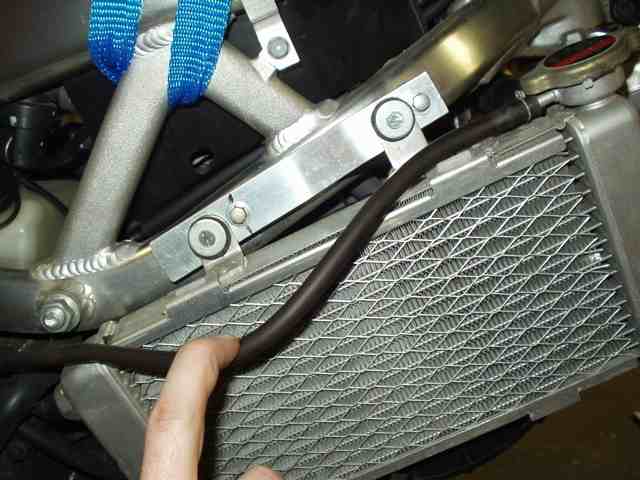

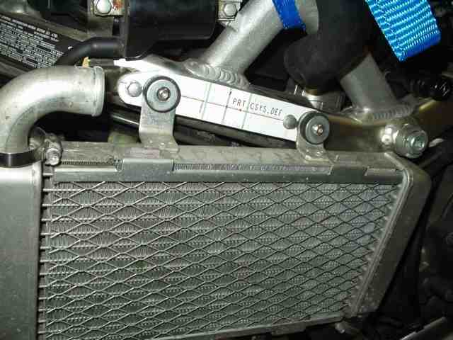

I moved mine back as well.... pics below...
I had intended to make a new bracket for those bottom attachments between the fairing, rad, and motor... but never did... so far I haven't had any issues with the rads not being held by that bracket...
Attached Thumbnails Frontend swappers rads move query-rad_bracket_start.jpg   Frontend swappers rads move query-rad_bracket_progress.jpg   Frontend swappers rads move query-rad_bracket_finished.jpg

Cool, thanks SlowH. The strap looks much stronger and easier to make than two little pieces. I'll be doin' that.

I like the 1 piece because it can't move unlike two individual brackets. That rad wil stay where you put it.
Only word of advice is to mark each rad L/R individually before drilling the holes in your bracker... as I found the tabs that hold the rads on were not the same distance apart... (about 1/8" difference).
You'll also need to put a small "S" bend in the bracket... you'll know what I mean as soon as you put some flat stock up against the mounting holes in the frame.

Saw the s bend...glad I didn't just make two . Thanks again...God I love this forum...and the net in general.
