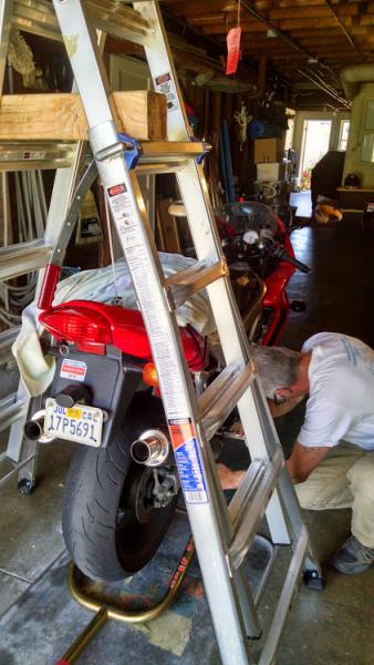

When I installed a new shock, I supported the bike from an A frame ladder, one of the type that is made so it can be straight or pivot and lock at the center. They can hold the bike no problem.
