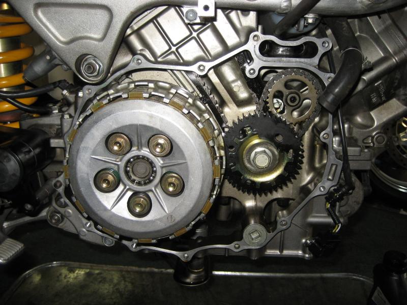

a little advance down low gets the motor to accelerate a little quicker. It also can be a little dirtier as sometimes the advance does not allow all the fuel to burn so lots of mfrs have the ignition retarded a little too much down low so it produces less emissions.
The advancer is the gold bit to the right of the clutch basket.

Here is a thread I started the other year when I reviewed my Factory Pro 4 degree ignition advance which was installed on my VTR996: https://www.superhawkforum.com/forum...ad.php?t=14246
The point here in particular is to make note of the picture comparisons I put up - so look closely at what you have in there [in your engine.]
-Matt
