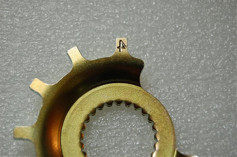

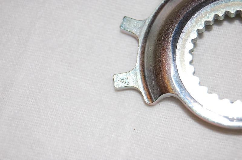

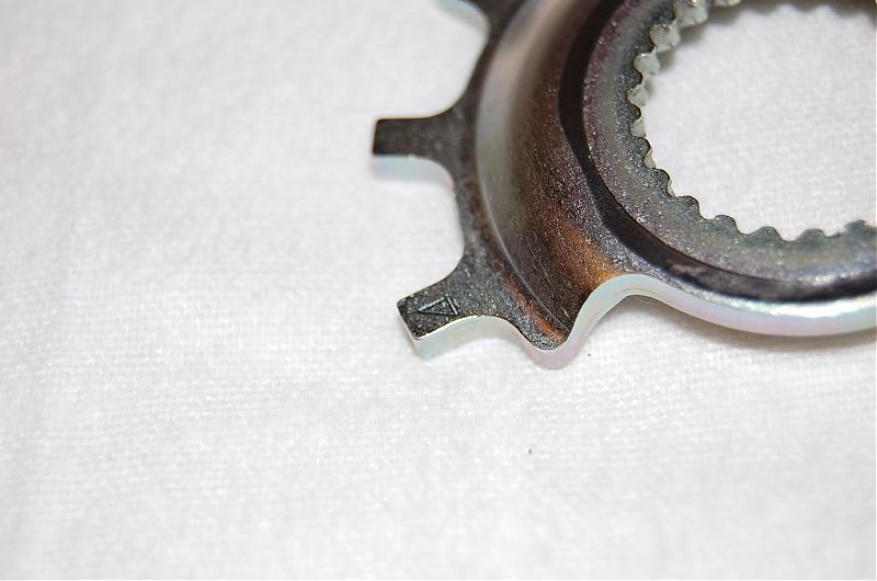

Guys,
I bought my 'Hawk over a year and a half ago and tried to improve the throttle response I was getting by going back to stock. The previous owner had apprently installed an ignition advance and I put a stock advance in, to attempt to remidy things.
So here's a few pictures, and I'm a wondering if this is Factory Pro's 4+ ignition advance? The only indication it's from "anyone" is this small right angle stamp in it. I've emailed FP and am awaiting a repsonse - but am also putting together an "eBay pile", and this will go with it - and am looking to answer my year old question today hopefully.
I know that some of you are up for one of these and I will only make it available through eBay when the time comes around so you can fight over it together and everyone has a fair chance at taking a shot at it if this part turns out to be what the previous owner said it was. ...I believe he said it was a 6+ deg' advance but I don't remember exactly and have reason to believe it is only the 4+ one.
Anyhoo - thanks for your input in advance...
Attached Thumbnails Is this the Factory Pro 4+ Ignition Advance?-996-4-ignition-advance.jpg   Is this the Factory Pro 4+ Ignition Advance?-996-4-ignition-advance-2-.jpg   Is this the Factory Pro 4+ Ignition Advance?-996-4-ignition-advance-3-.jpg   Is this the Factory Pro 4+ Ignition Advance?-996-4-ignition-advance-4-.jpg
Old Apr 3, 2008 | 03:57 PM
They made +2,+4 and +6 degree advancers but the +4 is the only one worth a damn....with that I can't tell you what you have

Thanks for the input 'Hawk. Anyone else have any ideas?

From what I recall that is the +4, I had one on my SH but later found out '02s on had more advance from the factory and sold it.

Thank you for the note Rick. We'll see if I can get a response from Factory Pro before the weekend arrives to confirm things.
Before I make this available to anyone, I want to make certain of what I'm offering to people - so - thank you both (Rick and Hawk) for your input as it gives me some sort of consumer lead in a general direction that I'm looking for before I hear from FP.
Also, were Factory Pro the only ones who made an ignition advance for the 'Hawk?

It'd be very difficult to differentiate between them without a protractor. That measurement is just too small to be able to tell by eye.

I'm going by the "4" on one of the points in the last picture - I recall my +4 having that on it.

Yea, I know it's tough to call.
And note: It's a right angled triangle stamped there - not a "4". I have no clue why someone would stamp a triangle instead of a true "4". But anyway - still no word on this from FP.

I really think this is a six degree advance - I think I remember the previous owner noting it as so - I think, but I needed your guys input - and I thank you for it. Beyond that, I specifically noted my gas mileage going up ~1.5mpg after I put a stock advance in. Maybe that helps in peoples assesment here.

Really sounds like the +6 to me, sorry to say. Maybe I'll ride up to San Rafel one of these days and just stop in at FP

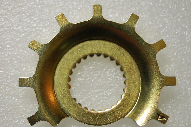

Late last week, I called Factory Pro and spoke with a "Mark" who asked that I send this thing (The ignition advance that you see in my first post pics') to them down in CA. It sounded like they had someone contracted out at some point to help out with making some of these and that some of them came out bad. I think this took place on Thursday, and I had it USPS priority shipped down to them the next morning.
Today, I got this in the mail, with a backwards "4" (Not some right angled triangle) stamped into it on the front face, with a more yellow colored plating on it.
So I'll give it a shot again. But I have to get up the energy to clean off that gasket Honda uses on these covers and drain the coolant - last time I was in there, I spilled a sufficient amount into the oil pan and had to end up pulling that - I always manage something intelligent......
As per this consumers experience with FP - they have done an excellent job of standing by their product.
Attached Thumbnails Is this the Factory Pro 4+ Ignition Advance?-4-deg-factory-pro-ignition-advance.jpg   Is this the Factory Pro 4+ Ignition Advance?-4-deg-factory-pro-ignition-advance-2-.jpg   Is this the Factory Pro 4+ Ignition Advance?-4-deg-factory-pro-ignition-advance-3-.jpg

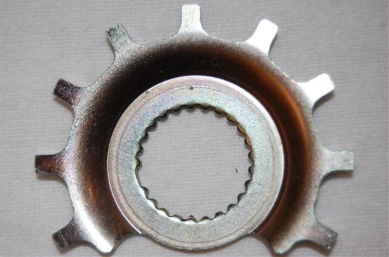

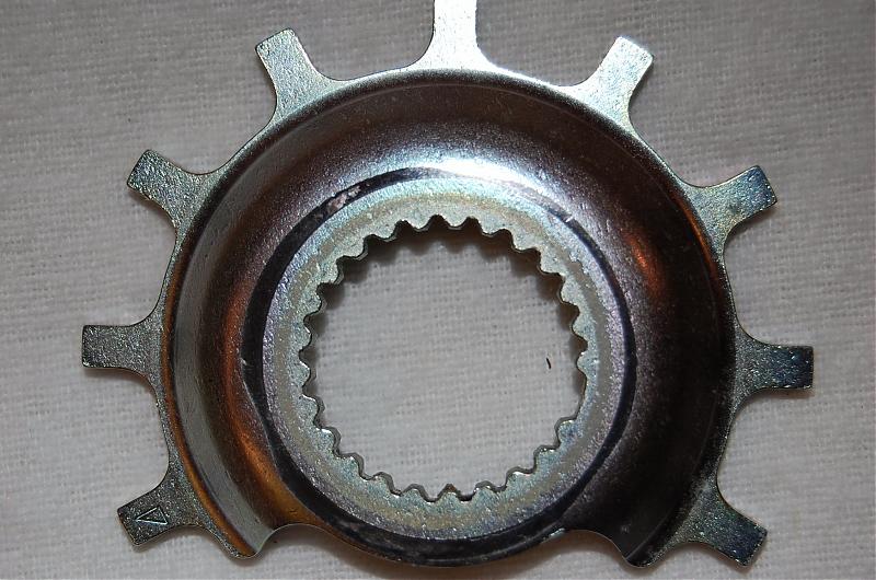

Here is the Factory pro and my stock (2004)
Here they are on top of each other:
I read somewhere that the newer hawk's are at 4deg and this sort of confirms it for me. So, I have a extra 4deg advancer.

You sure they're the same? Looks to me like the splines don't line up. Might be the pic though. Pay attention to the large spline location. Align those and then compare the location of the pickup points.

Hawkider, you have hawk eyes, and mine suck
I put them on the shaft and there is a difference,. Before I just held them in my hand and aligned them up and it sure looked like the splines lined up to me.
So My apologies to all.

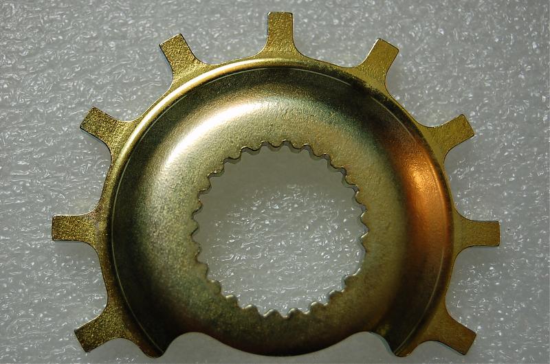

Ok, here's the update on the install of the +4 advancer on a '03. I compared spline to spline, stock vs +4 and there is an easily discernable difference, so I think it's safe to say that the newer bikes do not come with added advance. 60 bucks not wasted (phew)! Oh yeah, dont forget to lock down the primary gear before removing advancer. I found out the hard way.
Is that the gear I see behind the advancer?
Old Apr 25, 2008 | 10:21 AM
jbaxx's Avatar
Honducati
Posts: 809
From: Anaheim, CA
Yes, that's the one. There is a hole to put a 6mm bolt through to lock the gear to the tensioner. If you don't you'll have to pull the clutch out in order to reassemble. Ask me how I know!
