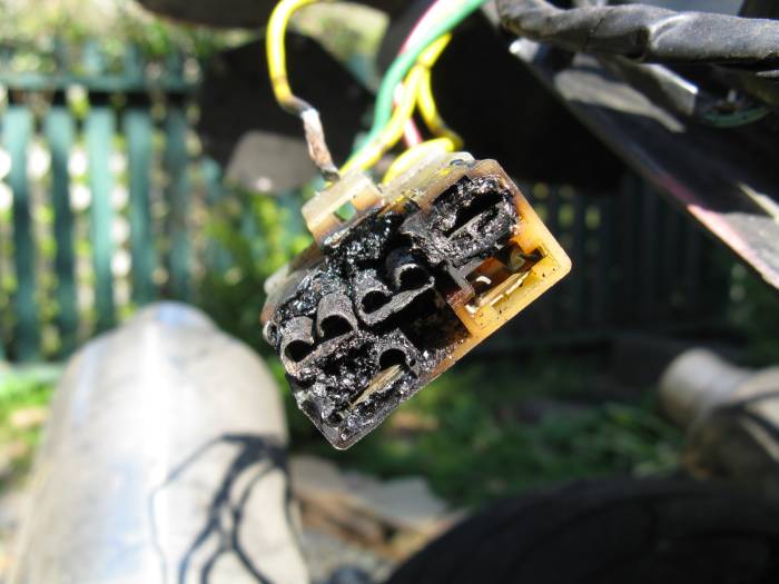

Im a wussy puss and wear an electic vest quite often.The vest is almost 20 years old,but still works.A couple of times now after stopping to get gas the bike has had to be push started.Im about to go out and check the charging system again.Both the R/R and stator have been replaced in the past couple of years with Electrosport parts.I think the battery is one year old.My thought's are.1...The vest is old and draws too much power.2...sometimes the revs are too low to charge the battery and run the bike and vest.Last time I was just loping along hope-ing to make it back to a gas station. Does anyone else use electic accessories.........Personal experience,Opinions and far fetched theories accepted.

well look at that,The wires going into the conector block look corroded and one pulled out easily as i took it apart.If it was in at all.

That's not corrosion... that's from high voltage... I'd check all voltages and all parts in the charging curcuit as soon as the connectors are replaced... It most likely to be an overcharging R/R...
I was going to say the same thing. Not corrosion at all.

Holy ****, dude! I think you found your problem!!! Yeah, that's due to high resistance connection causing excessive heat. You need a new connector. You may be able to salvage the actual connectors but if it were me I'd buy new ones and solder them when putting it back together. There's a place on the web that sells OEM electrical connectors but I never put it in my favorites. Try a google search. There's a few. Here's one: http://www.electricalconnection.com/index2.htm

I laughed so hard when I read that last night I coudn't respond.Anyways I don't think the vest did it.That connector got hot before when the R/R vibrated lose do to my lame bolt tighting skills.

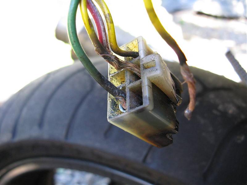

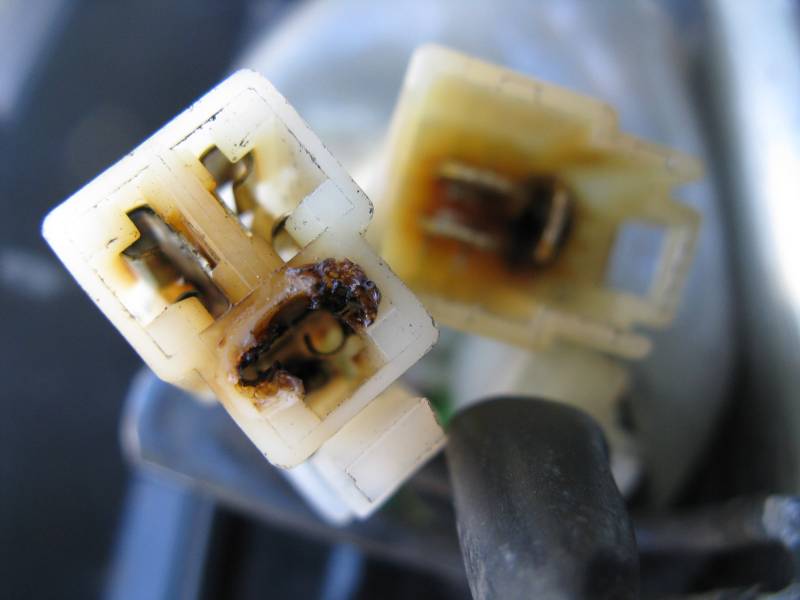

That time I blew the main fuse.I think some of the insulation on the wires in back got melted off.Then the wires started corroding.As I disconnected it this time one wire wasn't conected to the block.Every thing else seems OK,(I did ride it home)except for the stator connector at the tank.That burned connection is the same wire that pulled out of the R/R block.Couple more pics FYI.....And may I humbly say Im not a comuter,I use it more like a weapon.One of the best I've ever had.....Am I the only one who has an electric vest this is how rummers get started.
