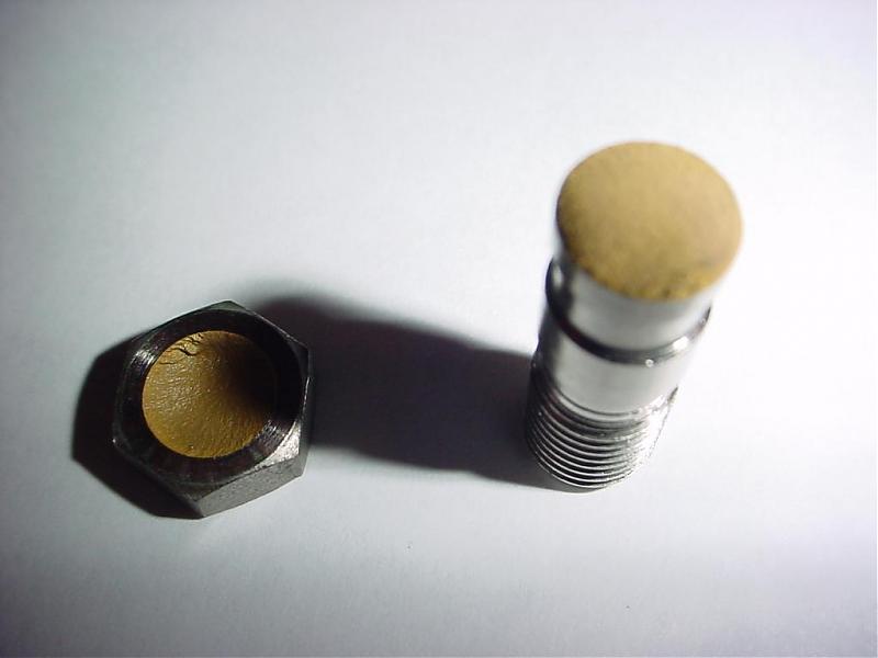

You really need to double check for leaks before you condemn the master cylinder. I've not heard of one going bad on the VTR yet. Soft, yes, but not completely shot as you describe.
About sometime around 2001 or so I was taking the ride out of my shed one chilly day. Grabbed the front brake lever and it got soft real quick. I discovered a leak at the master cylinder banjo. I went to tighten the bolt and just the act of putting the wrench on the bolt resulted in the pic below:

I will check again, the bike has been parked in the garage in the same spot for the last couple months, I found no leaks. I'll take it apart to investigate the cause. The brake has always been soft, tried ss lines, hh pads, multiple bleeds with different fluids. I have a TLR, couple dirt bikes and the SH brake has always been unimpressive. After reading the mod thread on upgrading the brake system it seems the way to go.
That pic is incredible, I'll take it apart to see but I bleed my brakes every spring.
Dam Greg? Not even at the threads (stress corrosion in the thread roots can cause fractures). Looks like a SS dbl banjo overtorqued or residual stress fracture pop.

i had a rear banjo bolt do the same thing hawkrider. i hadn't tighted it in the 2 years i had the bike at the time and i noticed the rear was soft and was leaking, so i went to tighten it and it fell off
Old Mar 3, 2008 | 09:29 PM
Well, this wasn't stainless or aluminum. Look at the color. Stainless should be more ductile too, with a larger grain structure, right? It looked like some kind of chromed brass or something. The fracture type was definitely brittle, not ductile. It was not overtorqued either. I truly think that the cause of the failure was brittle fracture due to temperature and low fracture toughness. There must have been a flaw somewhere in the metal that propagated due to increased tensile stress from the contraction of the material at low temperature. It was probably close to 0° at some point that week. The pic is old and I wish I could have taken better ones back then, but you can still see the stress concentration area in the bolt head.
I had one do that to me just a few months ago when I changed my master cyl. The thing just sheard at the point where the cross hole was drilled at and at a very low torque. It also appeared to be made out of brass.
I thought at first it was chromed steel but the color threw me; its always hard to tell from a pic. Did you check it with a magnet to see if it was steel, wierd if its brass? Who made it? Temperature could be a factor but there had to be residual strees and/or a flaw to start with if torque is not a factor. I've have used aluminum banjo bolts but not brass? HEL will not use aluminum fittings on the hoses or bolts though Russell and others do (see http://www.helusa.com/HEL_Performanc..._Aluminium.htm).

It was NOT ferrous. I checked, because when I saw the color of the material it piqued my curiosity. The part was an original Galfer part. They offered to send a new one after I sent them the pic. Needless to say I declined the offer.

Interesting, these lines are Galfer. Now I really want to tear into it and see what going on, hope it doesnt sheer off too.
Maybe it's a Galfer thing because now that you mention it, that's what mine was also, the one that came in the kit with the lines...

I don't think you have a broken banjo bolt.
I think you had an air bubble in the brake line all along. the brake lever should feel firm when it's bled properly.
I would say you have an air bubble that finally burped into the master cylinder. That's good news, because it's easy to get rid of now.
there's an orifice that supplies brake fluid to the master cylinder from the reservoir. Take the M/C off and wire it up so the orifice is at the high spot, then press the slave pistons into the calipers. You should see the bubble come out of the orifice because the bubble floats.
Reassemble and pump the brakes back up, making sure you don't run out of fluid in the reservoir.
Somebody should ask Galfer why they make their bolts out of sintered macadamia nuts?
