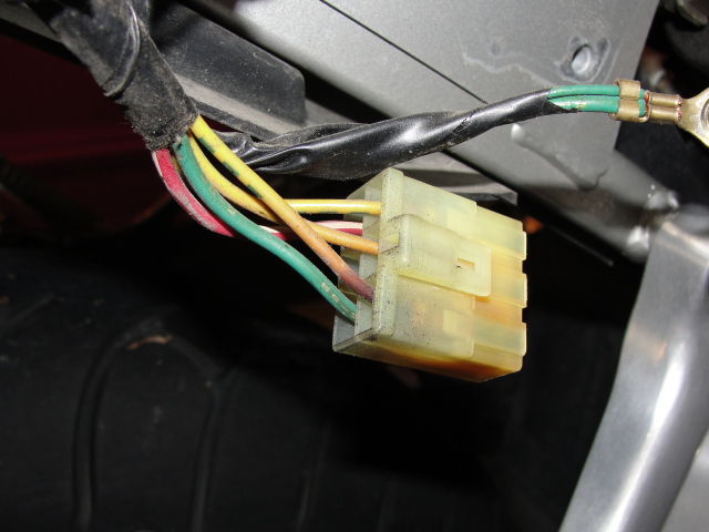

What did you replace the R/R with OE or upgrade? Did you have a look at its wiring harness? Mine was starting to show signs of heat fatigue.
Found my receipt for the R/R - from Ricks OEM style from 5 years ago.
And yes one of the wiring harnesses with I think all yellow wires has heat stress.
Course of action now should be what?
Clip the wires and get a new connectors?
Thanks

FYI - the wiring harness that I looked out that was distressed was under the seat & not the R/R connector. I will check that as well.
Thanks
And would U suggest a R1 type R/R or the Mosfet?

And - I relooked at the alternator connector (located by behind gas tank)
might this be the culprit?
I'm going to change this and see if that was the problem.
Alt. Connector
As the R/R connector doesn't looked burned - thus I'm not sure if the R/R is the problem
