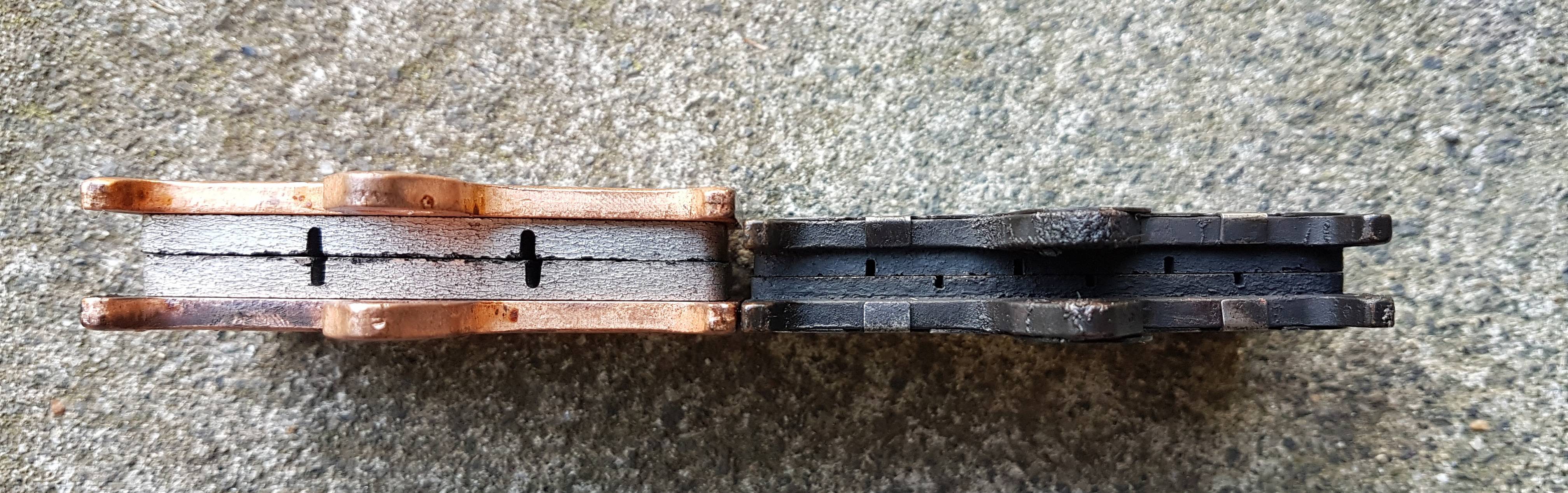

Another Update:
With the '97 calipers and MC installed, along with the OLD pads, the wheel spins about 1.5 rotations.
I'm going to leave it as that for now as the old pads have about 60% life left.
For reference, here is the difference in pad thickness between old + new:
Old Apr 6, 2017 | 04:02 PM
Posts: 5,223
Button it up and go for a ride. I think you're being paranoid. Let the new pads bed in then try and spin it.
Old pads still have a lot of life left too.
