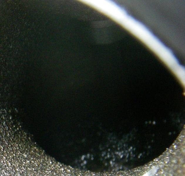

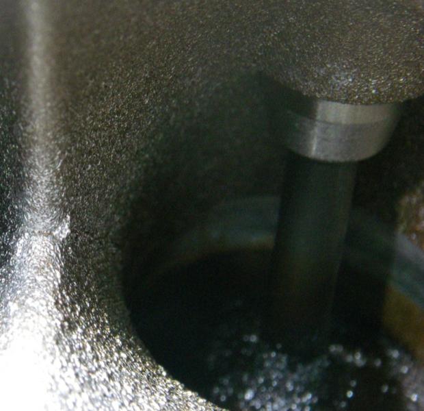

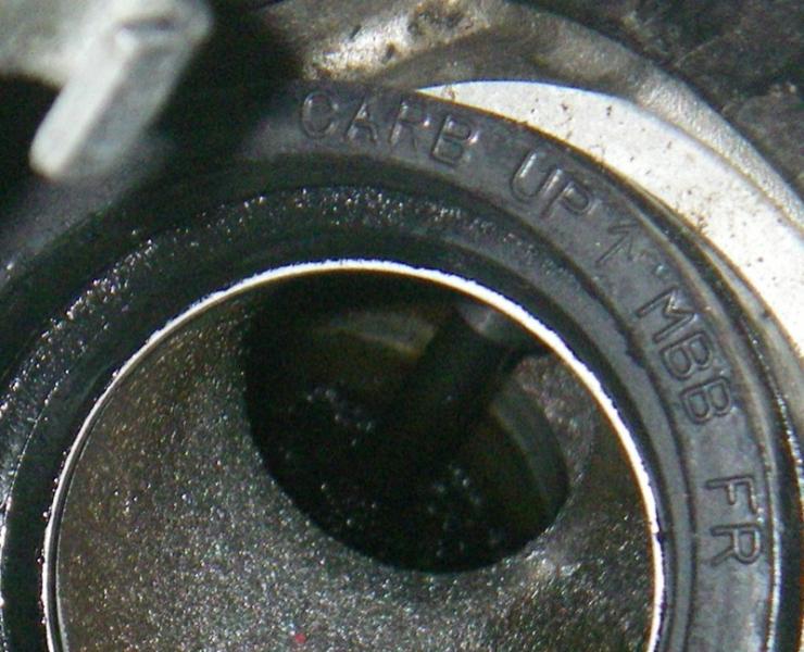

Yikes, I was shimming my jet needles today, and I happened to glance down into the intake manifold with a light shined directly into it - this is like the 8th time I've had the carbs half-removed, but just never really looked down there before.
Holy christ, the back-sides of my valves look like crap - all brown-blackish and gunky-crusty. Is this normal? Is it a problem? If so, is there any way to clean them up besides taking the head off and taking them out?
I'd appreciate it if anyone who's had good looks at lots of valves could comment on these pics. Sorry, they're not the best, taken at night.

Your best bet is to run something like Sea Foam every once in a while. Add 4 oz, or a quarter bottle, into the tank at fill-up and drive the **** out of it.

That is rather normal but the advice above is good. JIM

Yeah, intake valves usually have some crud on them. You may be able to reduce it but probably not eliminate it. Mine are a little dirty. I don't worry about it.

+1, looks like good ole ethanol deposits to me. Some techron will clean that off.

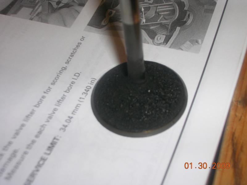

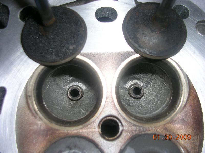

Yep, mine were bad too...let me know what you find that works?
Attached Thumbnails Do your valves look like this?-01-30-09-dirty-int-valve.jpg   Do your valves look like this?-01-30-09-dirty-int-valves-bowls.jpg

Mine looked the same way before the top end rebuild (unrelated - bent valves). After that I started to run only quality fuels in the bike, Shell & Chevron, and have noticed that the intake valves are a lot cleaner.
