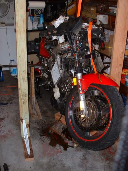

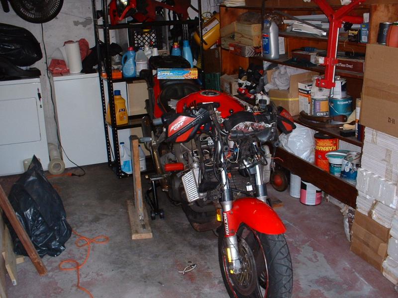

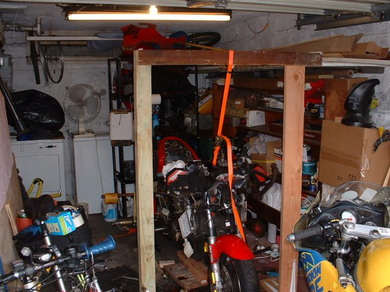

So the 05 motor just got into the frame. Had to do some on-the-fly building of a gantry crane to jack the chassis about 6 feet in the air. One day of prep, one of huffing the motors, and now one of buttoning up. Pics to come. It can be done by one person, it turns out. Luckily I can lift the motor as I had to do it many times.

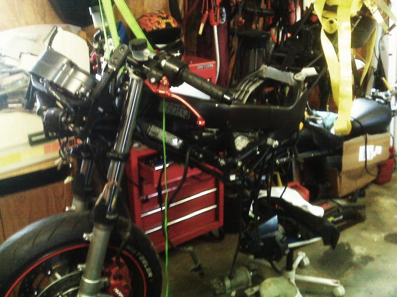

Yes but did you have front end still intact? What you describe would only work if you had no forks and front wheel on the bike. Without that it would be different but here in the city space is at a premium (like no place to put the front end) Or the other interpretation is that I was trying to save time so didnt want to disassemble the front end.

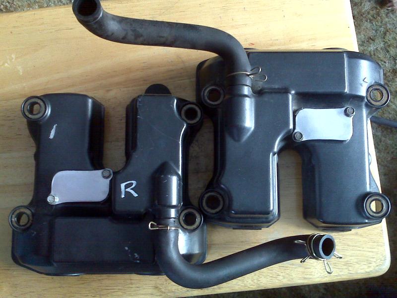

I just made block off plates and plugged the airbox and called it good. Its an easy thing but really just for aesthetics. I live on top of a hill and I got sick of the popping and grumbling going down the hill on decel. Here are the plates I made, some 16 gauge steel from the farm store and some good tin snips did the trick. Painted them black since tho.

Stump... under the plates there is a reed valve and little steel support with a phillips head screw in it... if you take the screw off and flip the support over it holds the reed shut. I can't remember why you're supposed to do this, but it's part of the PAIR removal process.

oh yeah I did that. I got so involved with making the plates I forgot I did it :-P

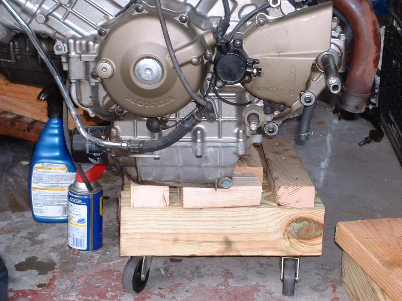

I had the motor on a wheeled dolly that held it the same ht as the standing bike, thats why the lift-o-rama.
