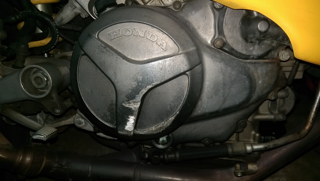

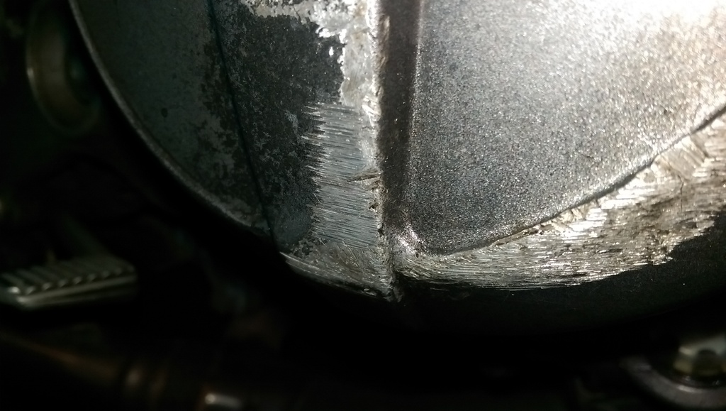

So since Im going to be taking off the right side cover and since the bike had been dropped the cover has developed some hairline cracks that I was hoping to jbweld until I found one used. What do you guys think. A friend of mine tried welding a similar cover and failed so I figure I can just smear some good ol jbweld and call it day. New it goes for a lil under $200 but would rather spend that on something else for the hawk

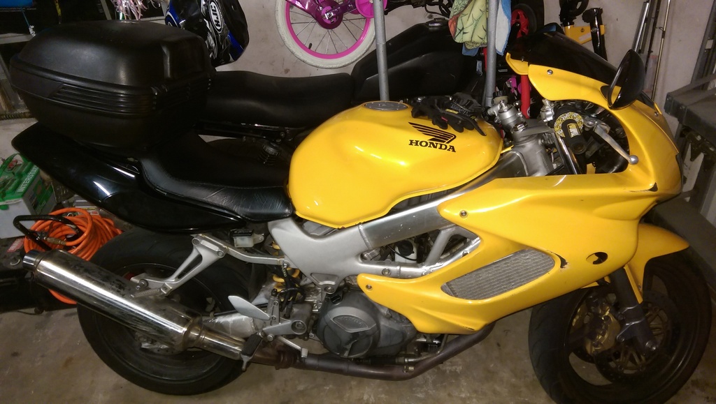

And Here is a pic of my beauty
