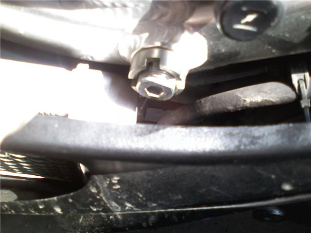

I have a leak coming from my engine mount on the left side. Any ideas why? Any good solutions for how to fix?

I'd suggest looking at the coolant reservior and the hoses from it... it's located just to the right of that bolt between the heads... and it may be leaking while on the side stand and just running down to that location.

check the water pump seal & hoses... they are all on the left side. your probably ( hopefully ) just seeing where it ended up.

It's leaking from somewhere above that location and traveling to where it is visible. You may need to remove the airbox to locate.

so I looked a little closer and it seems the line that is leaking is the one that connects to the front cylinder under the carbs. Its about an inch od. It looks as though the clamp is tight so I am assuming then its time to order a new hose. And to think I knew I smelled coolant for a while, but could never find why. The only pain now is I am going to have to remove the carbs, "son of a..." But thank goodness not a crack or something in the case, which was my initial thought. I guess those ideas are what happen after working on my mazda truck, where hoses last longer than intake manifolds and among other things. Thanks for the help reassurances.

since you're in there, i would check and replace the o-ring that seals the metal hose mount to the front cylinder too. i had one go out on me that caused a slow leak. the hose might be okay and it's just the seal that's leaking. the o-ring is cheap and i replaced both of them(one on the front head and one on the rear head)
