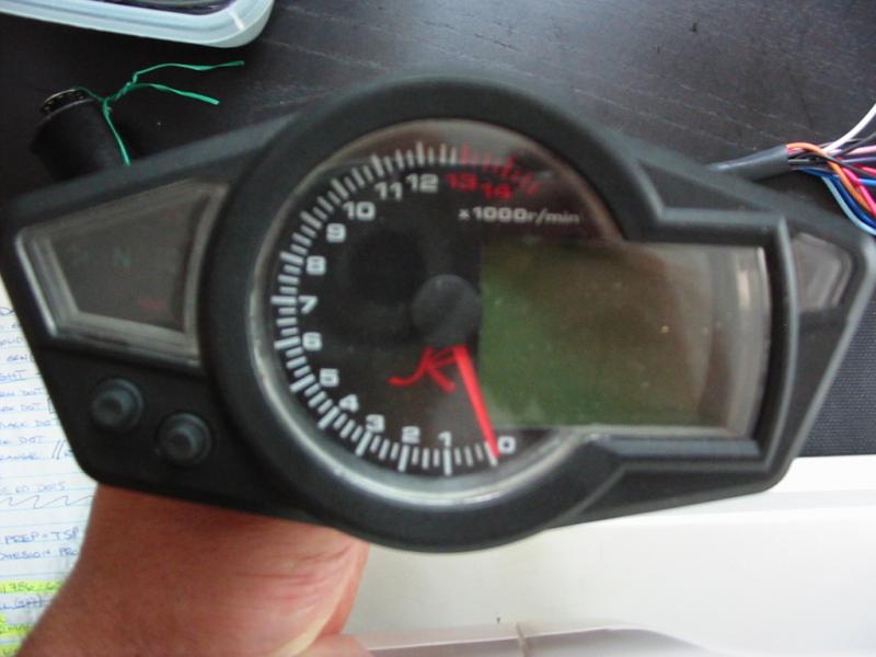

So I am installing an aftermarket dash. I need a constant 12 wire behind the dash cuz it has a clock I want to work.
Is there any constant power wires behind my 98 dash I can tap into?
Yes I can test em all but maybe someone knows
Per the wiring diagram in the back of the factory service manual, there should be a red wire with a green trace going to the odometer on a any 98-00 bike. Same for all other years except it also power the clock after 2000. This is a fused wire .
The red wire going to your ignition switch is also hot except direct to batt +, no fuse.

Thanks cranken, thats what I was looking for.
