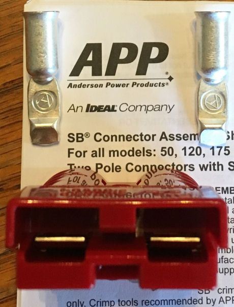

Can someone help me identify and maybe find a source for this connector. I keep it on my lithium battery and one on the vtr for jump starts. Im thinking molex or corsa as a source but what is it other than a high amp connector?
EDIT: It seems to be an Anderson sb50 but they come in different sizes. This one is @35mm wide.

If it is a real Anderson SB50, the housings is the same no matter if its the 50 amp one or the 120 amp version.
If it is a pattern part, all bets are off.
Is the connector marked Anderson? If so, the housing should match this http://www.andersonpower.com/_global...df/ds-sb50.pdf for dimensions, then you just need to pick cable size and use the appropriate sized terminals
If you need an Anderson SB50. I buy these . Heavy Duty Power Connectors SB50 RED #6 AWG 50A 6 AWG CONT https://www.zoro.com/anderson-power-...specifications 20 at a time for Jump box Quick connects on my training bikes.
Best prices Ive seen fast service, and quality product.

Thanks Erik. The connector says ANEN ANNENG CONNECTOR & when I google that it says its an Anderson.

Its an Anderson copy I think connector-Dongguan Electronics Technology Co., Ltd. and if decently copied, it should interchange with Anderson just fine.
You can get the ANEN ANNENG CONNECTOR on Alba, just need to buy a min of 1000 units...lol

This is a like angle view of an Anderson Sb50 to what you have....they look like they will inter fit Yes?

Yes carbon copy. Thanks
