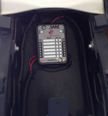

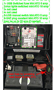

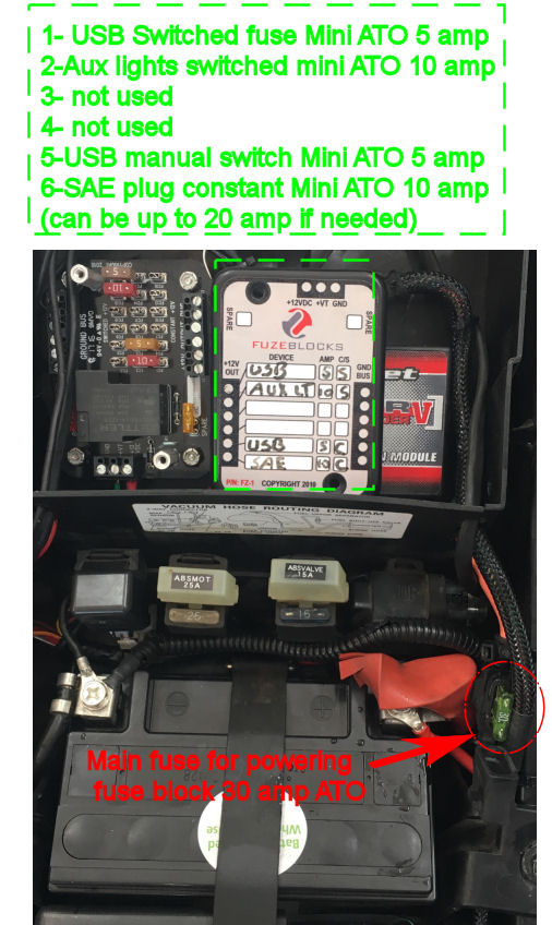

I prefer to install a secondary fuze block
FZ1 Welcome to Fuzeblocks - Out Stuff blows so yours doesn't is my current go to.
6 circuits for up to 30 amps.
Each circuit user selectable for constant power or key on
Small and fits well under the seat on a SH

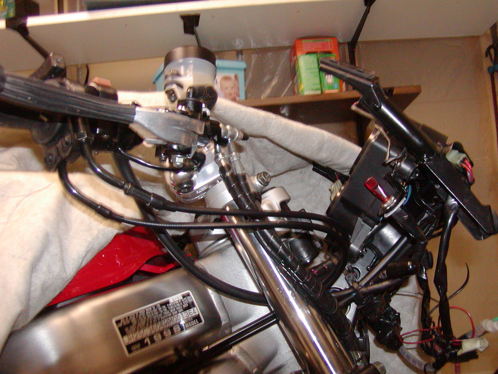

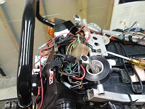

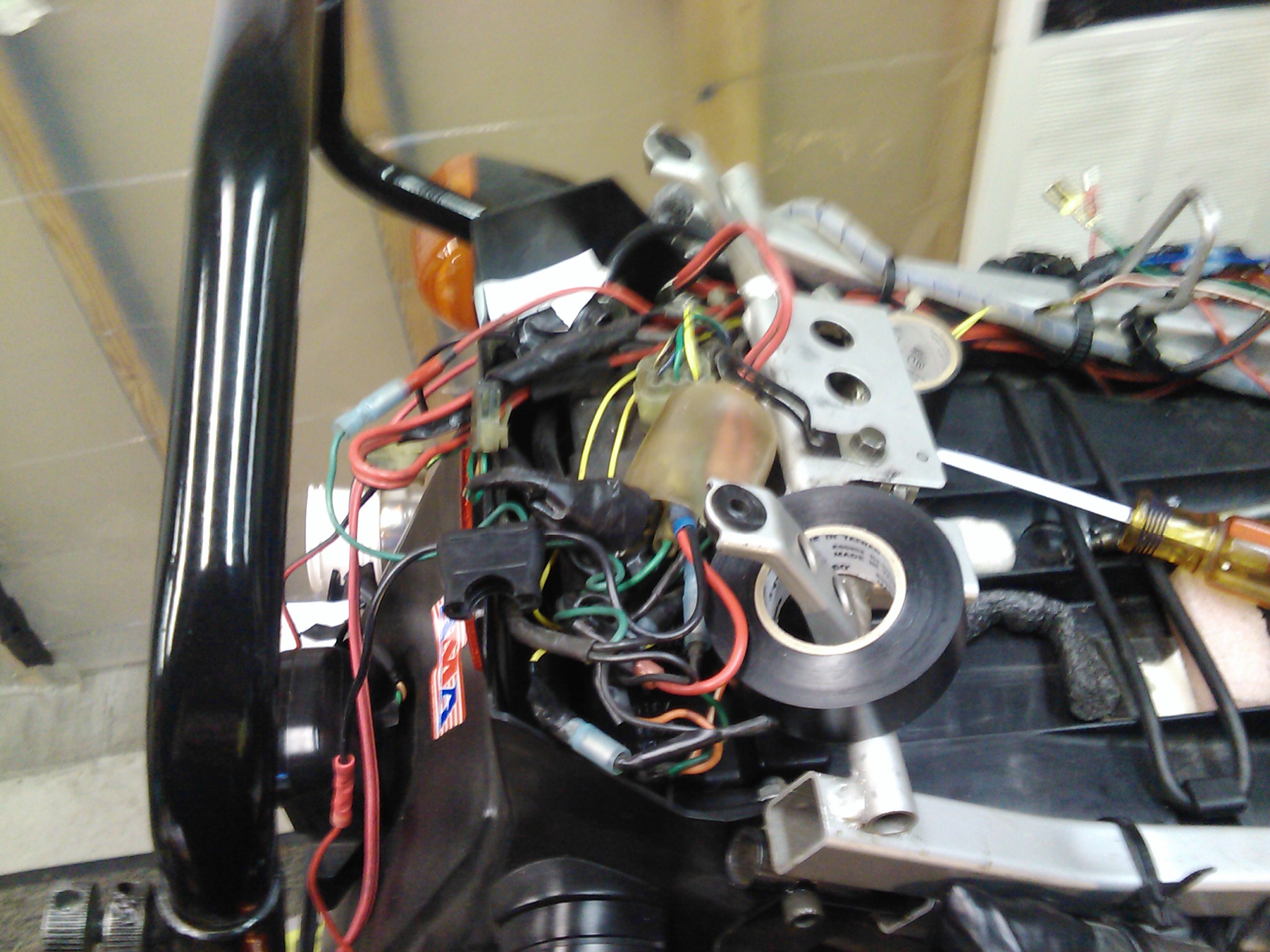

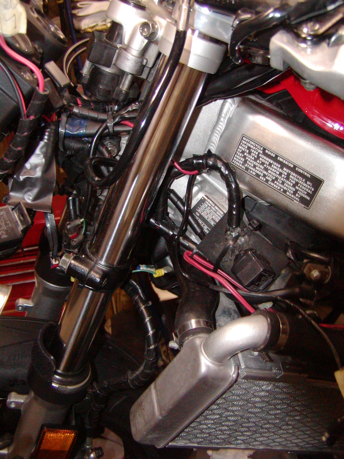

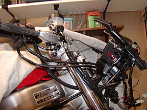

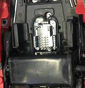

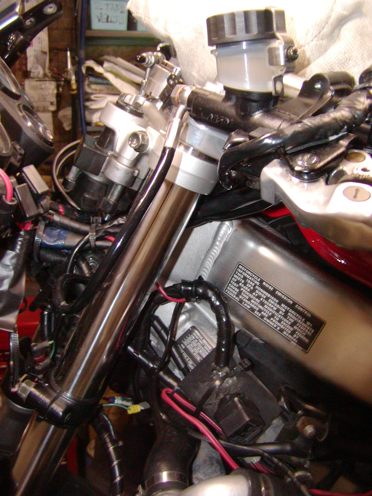

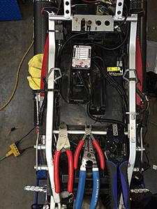

I must have added at least 25 circuits to my VTR through old fashioned distribution blocks with each circuit independently fused (or with a circuit breaker), and most controlled by a relay. It looks like well organized chaos behind my fairing, under the tail and tank, which adds at least 15 minutes to removing and reinstalling the fairing anyway.

Absolutely can be done that way, did it for years the same..
Erik,
#1 I started with my electrical mods right after buying my 98, so that was almost 20 years ago before all the newfangled digital fuse boxes and connectors were readily available. #2 the new black boxes (and some can be controlled via Bluetooth) are relatively expensive, where as my components were/are dirt cheap and available anywhere. #3 I did use buss bars for a central connection and distribution point fed by large gauge grounds and positive. This offers a very compact system with all the fuses emanating from them close to the devise or a the buss bars keeping things either centrally located or near the use point.
