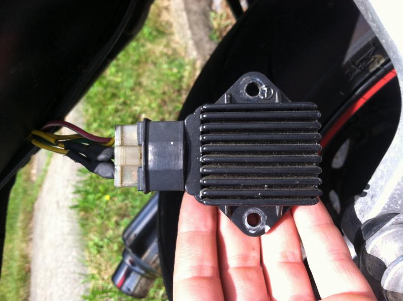

Old Jun 18, 2014 | 12:05 PM
Rebirth98's Avatar
Joined: Jan 2013
Posts: 87
Rebirth98 is on a distinguished road
Cluster issue-image.jpgAny chance someone can identify this RR for me?

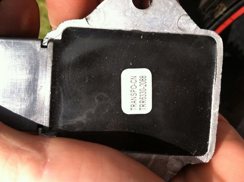

Old Jun 18, 2014 | 12:07 PM
Rebirth98's Avatar
Joined: Jan 2013
Posts: 87
Serial number on back
Old Jun 18, 2014 | 05:31 PM
Bandit400man's Avatar
Joined: Jan 2012
Posts: 423
From: ABE PA
Bandit400man is on a distinguished road
Looks like cheap aftermarket (google TRANSPO)...pitch it an get a yamaha R1 reg/rec...plenty of info here on that, including cross reference numbers
