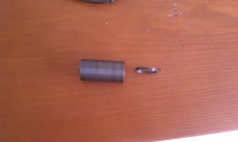

My rear home made manual cct leaks. About 1 drop of oil every 15 days or so. Not enough to make me worried about it, and not enough to make me even seal the leak (although I will eventually, I'm just really lazy).
I bought my 98 with 18k miles, no chain chatter and ran great. Out of no where the cct failed, luckily I killed the engine immediately and saved my head and valves. You won't get a warning before it fails.
This is what I found when I opened up the failed oem cct
That spring applies pressure from the tensioner to the chain. If it breaks, no tension and your engine jumps time.
Do what you want with your bike, but don't say we didn't tell you so.

I heard a very loud metal to metal slapping when mine failed. I was going about 35 mph, 3500rpms. Some may hear it and react in time, some might not. I too thought "oh ill just replace them when I get to it", that almost cost me a lot of money
