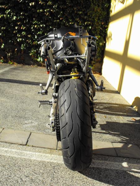

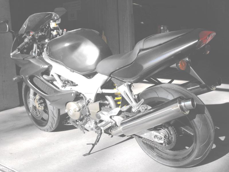

Not normal for me, my bike does not lean over much.
Attached Thumbnails Kickstands-2009-04-13-16-56-49_0086a.jpg   Kickstands-2009-06-12-11-20-32_0042a.jpg

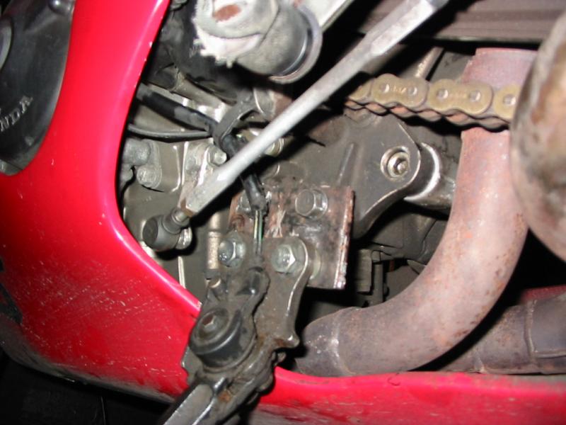

Yeah, my steel plate solved it, and it can easily be switched to stock it needed.

Did the extension plate last night. worked like a charm. Anyone with the problem should consider doing it. it beats carrying around a block of wood.
A few things of note. First, one of the bolts is part of the motor mount and goes all the way through under the motor. Second, my shift arm was in the way so I removed it to make the job easier. Third, as part of the plate fab, you have to cut a small relief section at the bottom center to allow space for the kickstand bracket to mate up to it.

the piece of metal I used was not particularly thick and I'm keeping an eye on it. However, from initial inspection it seems that the kickstand itself has more flex than the plate. The good thing about the plate is that there is very little distance between bolts so I don't think it has the stress of the stand itself.

well, so much for my fix. My initial piece of metal stock was not thick enough and last night while I was in the garage working on the Concours the kickstand gave out and the plate bent. I replaced it with 1/8 inch stock steel I had sitting around. It gave out on the garage floor because of the relatively slick surface that allowed the stand to spread out too wide.
The aftermath included a cracked tail section because it landed on the footpeg of the concours. It also bent the shifter linkage which broke in the process of trying to straighten it. Fortunately I had some spare track backup parts to put things back together. I'll be needing a rear section though, because my track plastic is pretty beat up.

by the way....1/8 inch steel gave way on me again after I got home from work today. I've now made another bracket from 1/4 aluminum that I had in the garage. If this doesn't work, I'm going to have to get more creative with a piece that has an angle to strengthen it more. it's only happened to me in the garage where the kickstand more easily slides on the smooth concrete.
