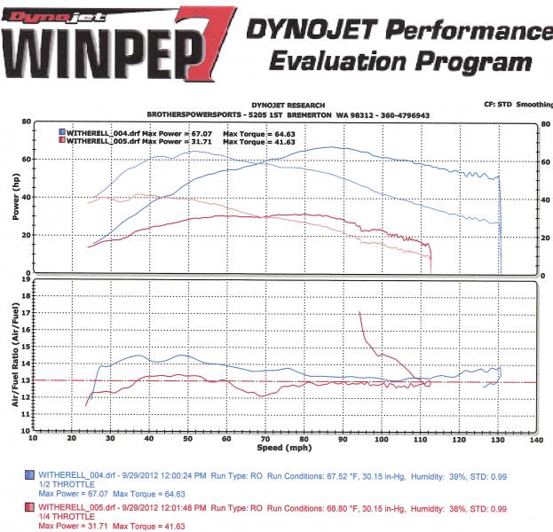

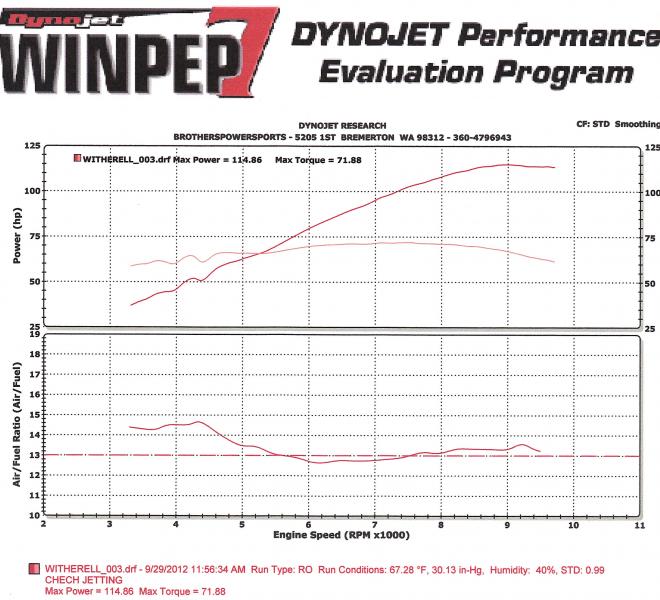

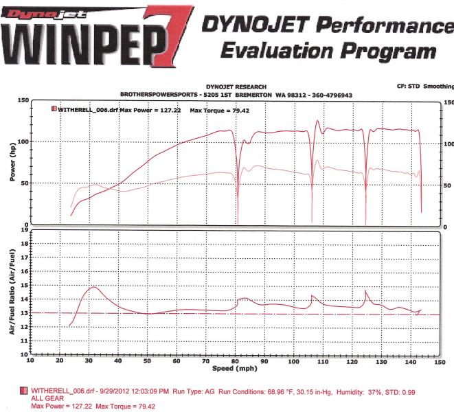

Hey gang, So, I performed your recommendations and so far so good. Actually at ~115 hp, I believe that I'm 10 hp over the dyno I did with a K & N and dynojet kit (it was some years ago but I believe it was at 105 hp, at the MOST it was 108hp). I have 1 question for ya'll. The tech, who is VERY knowledgable (has been building race bikes for years for years for many successful people, organizations) noted that everything looked really good accept that he said it was "pretty rich" at idle. I think it was hovering around 8 or 9 when apparently 13 is the magic number. His though before we went through all the test was to lower the needles and turn the mix screws in a 1/2 turn. After all the tests, he seemed very happy with the results and said maybe just turn the screws in 1/2 or even just 1/4 and see what happens. Unfortunatly I didn't bring my tool so couldn't do it on the spot. I'm just wondering what your thought on this are. I know that the bikes like to be a bit rich but is this abnormal given the results look pretty dang good in all other regards? And, would turning the mix screws in a bit affect the results we got negatively in terms of hp or torque? Thanks so much for your time and any imput... Oh yeah, dyno results are attached.
Oh yeah, also, both needles are the same height as I could not really find the right thickness washers (or perhaps too lazy) to get the front a tad lower. If I recall, both are close to .40 above stock. #48 pilots, stock mains and stock filter. Thanks again.
