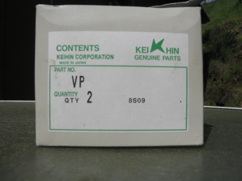

Here are a few new pics to update this tread a little...
The nice thing about the HRC jet kit is that all the parts come in these nice Keihin packages....
