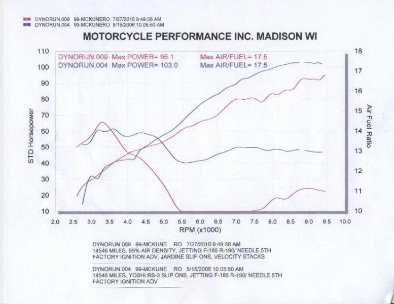

From: Madison Wisconsin
Ok so I have read this thread and cut and pasted and then printed out what I thought was the important parts then read it again and this is what I think will work for my bike please let me know if I am accurate with this formula. I have 2 extra sets of carbs for parts but I have not taken them apart yet. Hoping to find stock parts inside when I take them apart. Then use the dyno run that I included to set the jetting. It runs rich right now as I have 3 holes in the slides with the DynoJet carb kit that is installed on the carbs. I plan to set up the carbs without taking anything off of the existing carbs.
Air Filter - BMC Street replacing the existing K&N filter.
· Mr. Honda Velocity Stacks.
· One hole modification for the front and rear slides.
· Shim stock needles and springs front .030 and rear .40.
· Should I run the Emulsion tube stock setup of different front and rear or both rears?
· Jetting F-185 R-190 “look at dyno run below will use Jardine slip-ons and 4 deg timing advance”.
· 48 pilot jets.
https://www.superhawkforum.com/forum...g-dyno-run-jpg
Old Aug 17, 2013 | 09:21 PM
  #286
HRCA#1's Avatar
Joined: Oct 2007
Posts: 1,082
From: Menifee, CA
IMHO you'll be too rich on the mains.
Stay stock on the emulsion tubes.
Stock paper filter!
Old Aug 18, 2013 | 03:24 AM
  #287
Stephan's Avatar
Posts: 219
From: Prague - Czech
Stephan is on a distinguished road
I agree, after putting Dr Honda stacks, I went one size down to 178 and 180. Paper filter. With cotton filter, 180 and 182 should be fine.
IMO change for BMC instead of KN won´t make much difference, they are almost the same. Paper filter does better job.

Ok so my carbs are apart and this is what I have to chose from to run or get some new parts Is there a air/fuel screw that is already slotted or just slot the Honda ones I all ready have one new one part # 16016-MAS-640
  • 4 - Slides I plunged one hole on all 4 of them.
  • 1 - Set of Dr Honda stacks
  • 1 - K&N Air Filter
  • 1 - BMC Street Air Filter
  • 4 - Stock springs
  • 2 - stock needles
  • 2 - DJ needles
  • 1 - ftg or ptg usa 50k jet
  • 2 - 45s jets
  • 1 - 48s jet
  • 2 - Honda 175
  • 2 - Honda 178
  • 1 - Factory pro 182
  • 1 - Factory pro 180
  • 1 - DJ 170
  • 1 - DJ 175
  • 1 - DJ 180
So out of all the parts I have I think that I think I should use
  1. BMC Street Filter
  2. MR Honda Stacks
  3. Factory Springs
  4. Shim stock needles front .030 and rear .40.
  5. 1 air hole slides
  6. can I use the 45s or should I get another 48s jet
  7. Honda 175 front
  8. Honda 178 rear

Ok, you're going through the same rigmarole we've all done just for fun and now it's time to get the job done right on a stock engine machine. I ditched the 48 jets as they're too rich at sea level here and Madison is at 1200' elevation. Also stay with the stock mains and springs and get rid of the wire gauze air filters as they screw up the airbox resonance even if you stack them like I did. I glued a K&N atop a BMC race filter and added a air dam like stock filter has and still didn't like the idle/slow running. If I go back in there again I'll remove the slide needle shims because at this elevation I don't think they help and it may even run stonger. This one runs super bottom to top and it will never make more than 100hp no matter what. It's all in the sig------
One more thing. I made a plug or baffle to fit in the right side Jardine can tip and it I think it makes the over all throttle response better, too.
  2. MR Honda Stacks
  3. Factory Springs
  7. Honda 175 front
  8. Honda 178 rear
If it were my bike, and based on my personal experience, I would start with exactly what you have listed. You can play with the fuel mixture screws to see if going richer helps... if it does you may jump up to 48's. I can get 45's to work well with mine (48's don't pass emissions, so I've switched back and forth) and some people find they work better than Mike's suggested baseline.
