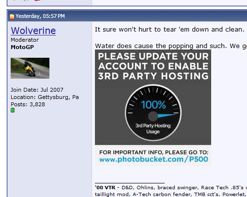

It sure won't hurt to tear 'em down and clean. Maybe not necessary but with being that deep I think you'd be crazy not to. Especially considering your "boggy" description.
Water does cause the popping and such. We get it frequently @ work. Usually draw the old stuff out, refill with fresh treated with an ethanol stabilizer. Also drain the carbs with this screw:

Use the Go Advance button to attach pics.
I think he means he cant see pictures that others have posted. I have noticed this lately myself with pictures from several long term members including you and Eric.
Old Jul 14, 2017 | 03:19 PM
Oh!! Yeah, photobucket is being an arsehole!
