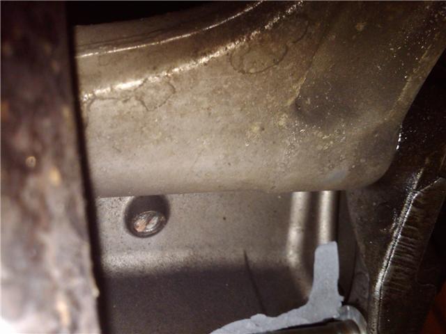

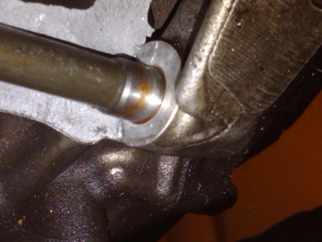

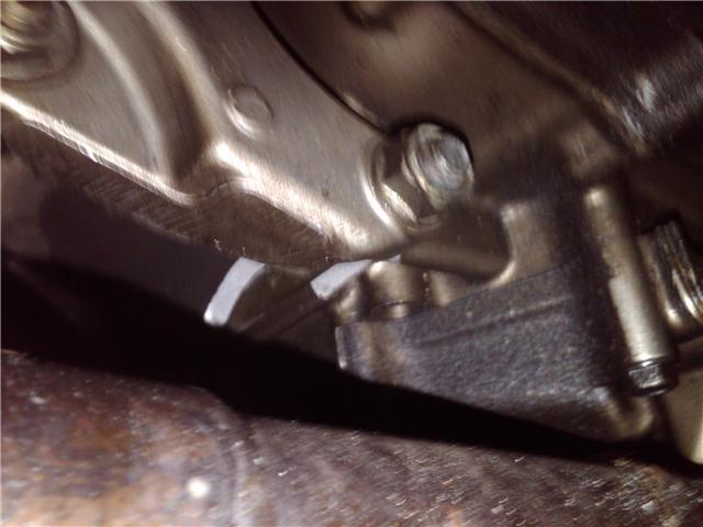

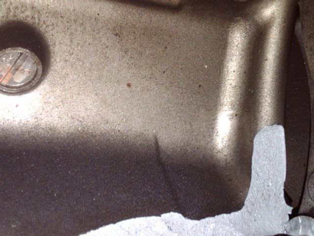

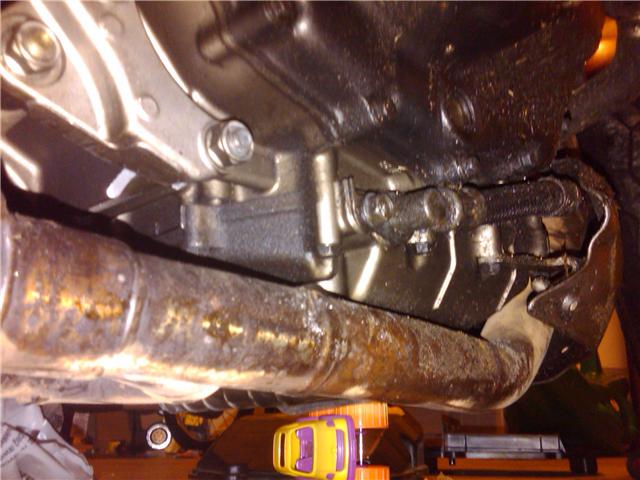

hey guys i was wondering if anyone knew if it was possible to repair the mounting points for the rear link on the case my girls gramps and i stgarted tearing the hawk down some more to do some closer inspections and noticed that on the right side the hole for part of the rear link mounting point is busted. Or should i just get a new case. have been talking to someone about a short block already just curious if this would be salvgable possible even as a spare block

here are some pics sorry they of my blackberry

bet that bolt was incorrectly torqued

That's exactly where my problem was. Mine was only cracked and not missing any pieces.
I am also curious if this is a common issue. When I noticed my crack I did some searching around here and didn't come up with any info on it. I thought I was the only one till now.

Here in the UK, due to salty winter roads, the rear suspension linkages can get heavily coroded leading to seized bearings.
http://www.vtr1000.org/phpBB3/viewto...p?f=31&t=11809
Though I suspect as hawxter996 suggests that it has been overtorqued at some point. However it came about, dropping a new secondhand engine in and recouping your losses by selling the old one as is, would be an easier option than the hassle of installing new cases IMHO.

thanks for the pics. after seeing the pics i went to check my bike. and mine looks good but i can see how the parts could break they look awfully thin and easily broken. i will be sure to lube this joint from now on during maintenance. thanks again.

no problem thanks for the info guys/gals yea over torqued and possibly also a result from the bike being in the accident it was in before i picked it up ill get a used short block and most likely to a fresh rebuild to play it safe
