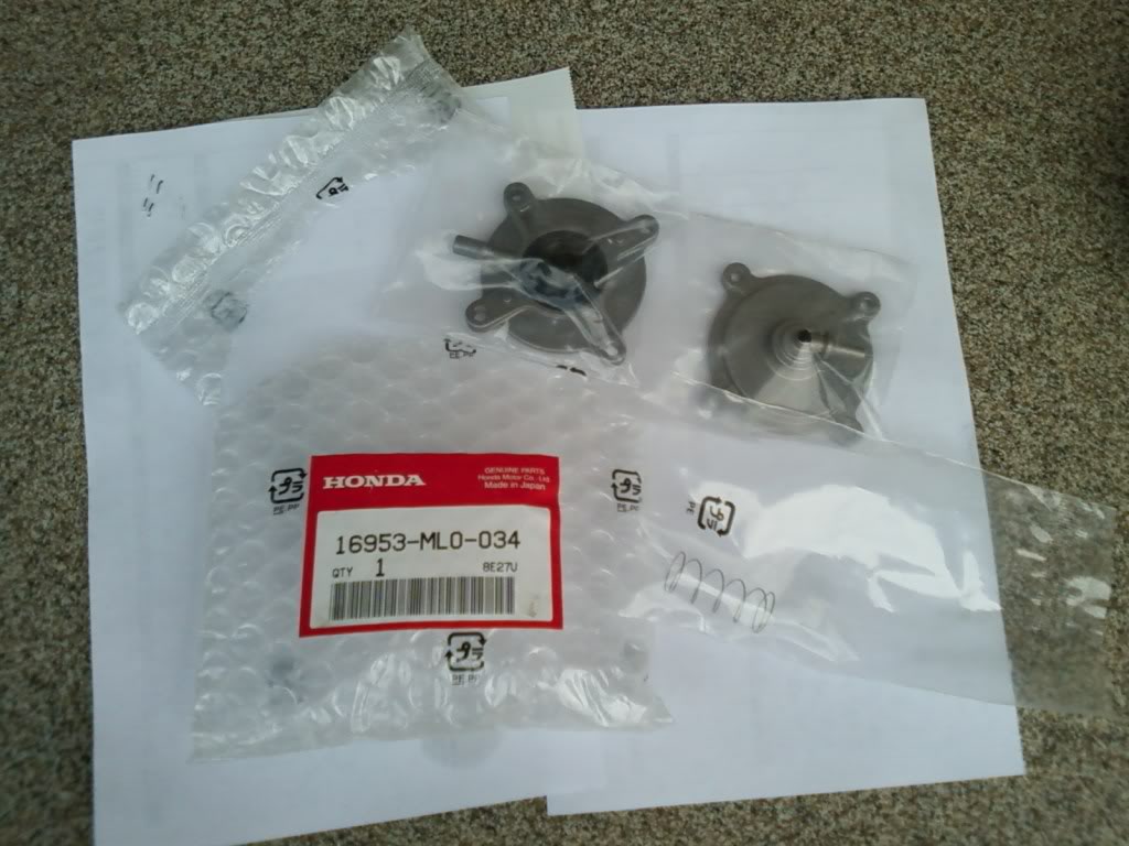

This is what's in the OEM cover set:
(image sniped from another member on this forum somewhere)
