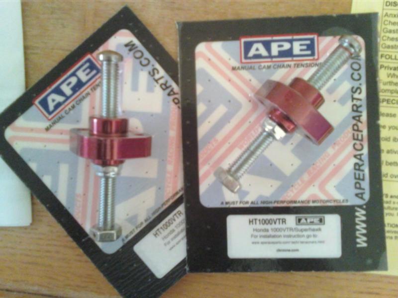

On Sunday night I ordered a set of APE Manual CCT's.
This morning I received them...1 1/2 day turnaround. I can't say enough about their service.
I installed them exactly as per the write-up on this forum under the Knowledge section. I have Strong hands from being an aircraft mechanic.
I do need to say one thing about these APE's-- The tension is somewhat vague on these APE's. I installed them as tight as I could by hand while grasping the nut on top. If you have strong hands- don't do that.
I got a faint but noticeable whirring or whistling sound ( more than these Hawks normally have ) from the cylinders. I am absolutely certain I was at TDC during installation as I pulled the rear cam cover and zip tied. The front was done without pulling the cover -but I was certain nothing moved. So, I figured the cam chain was running really tight on the guides and sprockets. I figured right.
I took APE's recommendation of going just hand tight ( without gorilla twisting it) and then backing it off a half turn. Presto. Problem solved. So, I think some Superhawk owners may be installing these too tight.

The APE nyloc nut can be tricky to tighten if you use a tool to hold the bolt stationary as you lose some of the feel for finger tight - but once you add the 1/4 turn slack as you found out you should be okay. Also add a smear of blue loctite to the bolt shaft thread as it enters the CCT body to prevent oil leaking up past the O'ring.

I used a 16mm to hold the bolt and a 14mm box wrench to tighten the nut.
I put a black sharpie pen mark on the bolt head facing forward so I knew if it was turning ( or will in the future). It worked great. I figured the O-ring would suffice to keep oil leaking out. Your idea of blue lock tight below the o-ring is smart. I did however use some blue LT on the hex head bolts that hold it to the case. I guess I shall see over time if it weeps a bit. I can always go to TDC, back them out a bit, add LT, then re-adjust in about 10 minutes if a weep should occur.
