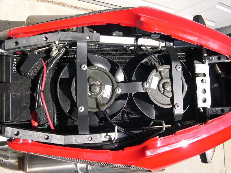

Smile Second fan
I added a second fan to mine.................
Sorry, just couldn't resist.
Kai Ju

That should keep the 'hawk cool
Kai Ju

Yeah, but you lost all your undeseat storage! ha! Also serves as a rear tire warmer!

Hey Hawkrider, do you have room for two fans under your seat ?
I do.
I also don't get poached by heat coming off the front mounted radiators.
Kai Ju

Handwarmers
I use Acerbis UNIKO Hand Guards with heated grips......which I can turn off.
In all seriousness, I've been running the underseat radiators for over three years with no problem. I don't get heat soaked from the front mounted radiators and cannot feel any heat coming from the underseat set up. The second fan rarely sees any use even though the primary fan does cycle constantly. ( I'm still looking for the natural airflow solution )
Other than the loss of underseat storage it's been a very successfull mod for me.
Kai Ju
