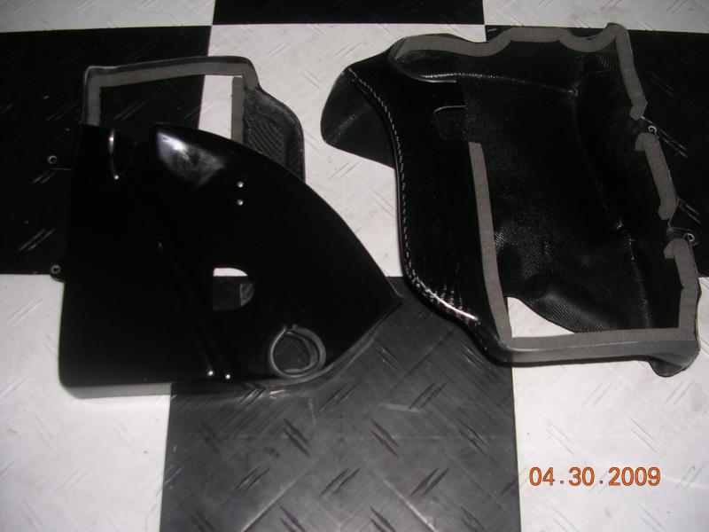

I think the RC51 cooler should be adequate. One thing that is often overlooked is the amount of heat that radiates to the oil from the front exhaust header. Some header wrap there and next to the rear shock will help keep those items cool.
I never had cooling problems with my engine with the stock radiators. The cooling fan only came on when it was really hot out and I was stopped in traffic, which wasn't very often. Air scoops to help pressurize the front side of the radiators seem like a good idea and they have been shown to drop RC51 temps substantially at speed. Rick has a set and will likely chime in.
If you go with a larger oil cooler, be sure to drop the nose, by taking the fork top caps off and check clearance.

If you have a few extra Canadian nickels laying around the scoops work great!
Old Feb 24, 2010 | 04:20 PM
They are nice. I just find he is asking a whole lot of money for them....
