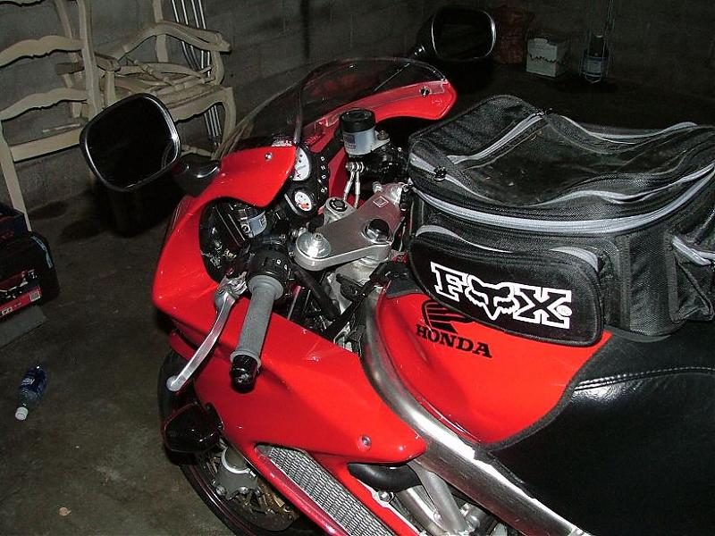

If your triples look like this (see pic), then they are probably 900RR triples. Up to year 1997 (changed in 1998). I've never heard of other triples being used in the mod, but there are other bikes with 45mm fork legs (cbr600rr with conventional forks for example). I did my fork mod a number of years ago, so sorry I can't help out much with details.
Yep, that is the same as far as I can see, thanks, answers that. Did you use stock calipers from your Hawk or did the 900rr calipers swap also ?
