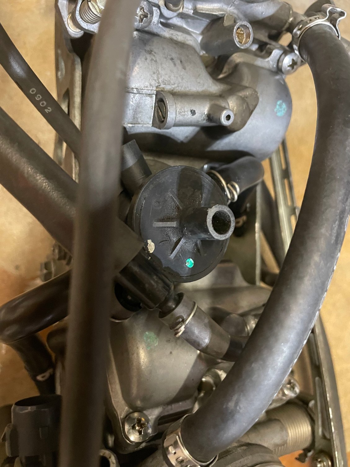

Hoses, a new form of torture
I have the manual but can't figure out what hose goes where. For example, can't find this black device in the manual, but there are supposed to be hoses connected to it. If someone has a easy to understand schematic of the hose connections, i would appreciate it. I have tried on my own, but I have to reach out now. Thanks.
The center piece is one of the connections I can't find what attaches to it.

Also, it's not a California bike. Was bought from someone in Washington state.
