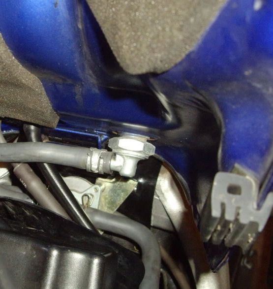

Am I just stupid, or is there no gas shutoff on my bike?

These bikes have a vacuum operated petcock. Yours, I believe, is mounted to the frame under the tank.

8mm valve on underside of tank. That's what my 98 has.
Old Apr 21, 2019 | 05:27 AM
The VTR has two fuel shut offs, in the same valve.
The fuel petcock is both automatically open and closed by vacuum and it has a manual shut off as well.....
The valve is located on the rear bottom for ALL VTR's that used the 16L tank (ALL US bikes used the 16 L tanks, other markets got the larger 19L tank in later years)
the Larger 19 L tank used a remotely mounted fuel valve
The valve open and closed by vacuum, so no user activation needed before starting or after.
That same valve has a manual shut off feature as well.

Thanks for the answer, and for the pictures. I am just happy that I cannot forget to turn the gas on.
