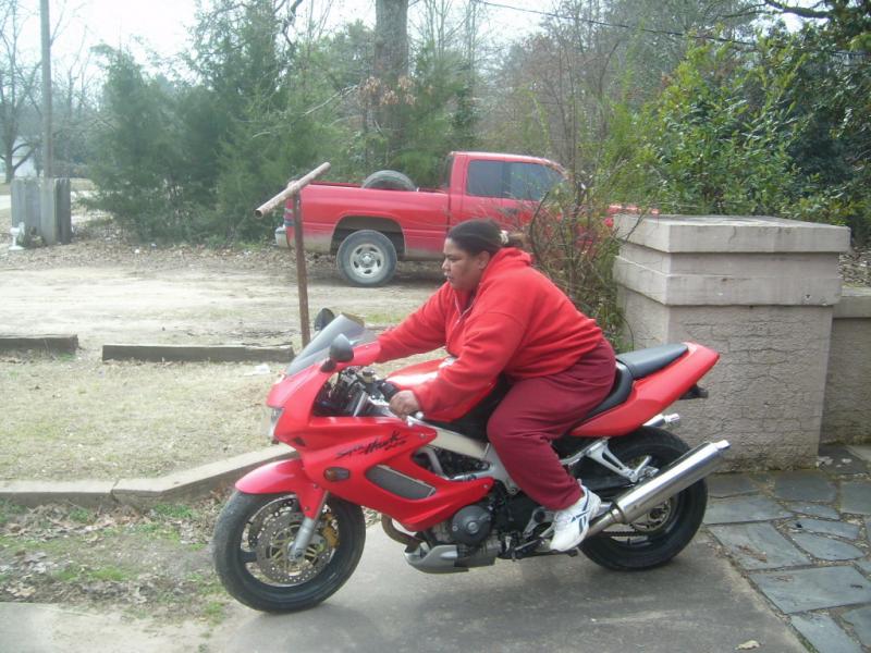

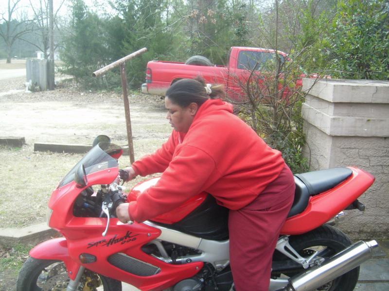

Got my other plug changed now its a whole different animal as far as power! But now i have a backfire if i rev the engine.Plug wires maybe.It doesnt miss or anything .Help hope its not jumping time.What headache did i get into.My wife loves the bike though maybe i,ll go with something else?!
