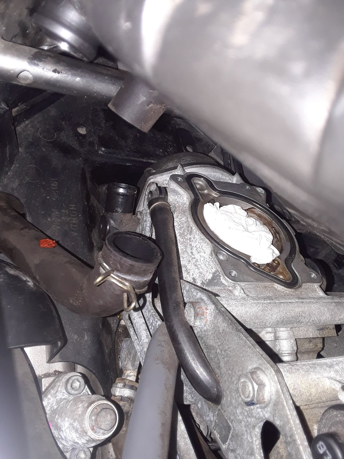

1998 superhawk. Something blew on the highway
Took the carb and airbox off, which btw all of those hoses are so tight i cant even imagine how im going to reconnect them back to the bottom of the carb and airbox.
first thing i notice is that any deep18 mm socket wrench i can find anywhere wont fit in to grab the plug. Walls are too thick which is ridiculous honestly because they arent even thick to begin with. 17 mm doesnt fit the plug. Trying to pull the plugs because turning the crank with no compression is helpful. Can also just inspect them while im in here.
Now im realizing at this point, the rear plug is loose enough to turn with needle nose pliers on the top of the plug. In a momment of clarity i think to myself, my entire problem could be the power loss was yhe plug vibrating loose. I was either on one cyilnder or it was still firing but had enough compression loss to make it feel like one cyilnder. Next thought, is it loose enough for my valve tap sound to actually be that plug shaking in the slot? It wiggles very slightly.
screws in airbox are worn, so all of this has definitely been pulled before. So im hoping the CCT has already heen replaced, ill find out and check the timing anyways.
Not sure if the vid really sounds like it could beone cyilnder, sounds like theyre both firing to me but the power the bike currently has is definitely consistent withone cylinder.
Anyone have any advice on getting my plugs out trying to find a tool local today. Also any advice on reconnecting the carb and airbox? Everything is so damned tight i really cant inagine my hands getting under anything to fit hoses on anywhere. Thats actually got me concerned. The socket issue eith the spark plug is definitely ridiculous to be honest. Autozone ans homedepot had nothing that would work for it. Im going to check out harbo freight. I read on the forums a tool that screws into the boot threading i believe? I cant seem to find this.
