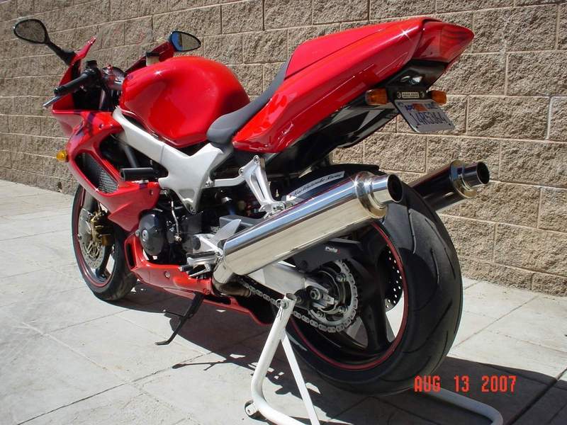

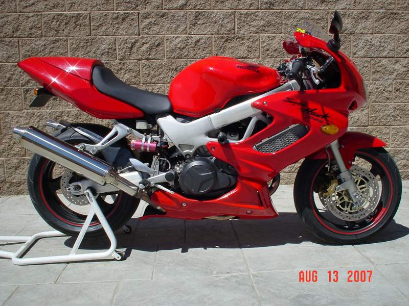

Okay, so after a recommendation from Dennis Smith at Sporttire.com (West Coast distributer for Dunlop) I tried a 190/55 on my GSX-R track bike (5.5 in. rim). Felt very good, so subsequently I decided to roll the dice and try this profile on my Superhawk. I wanted a street tire however, so I bought a set of Michelin Pilot Power 2ct's from Sportbike Track Gear for under $300 a set, delivered. I must say so far I'm very happy with them after 500 miles of twisties. It is a bit heavier than the 180/55 but steering input hasn't change too drastically. The 190/55's taller profile also raised the rear a bit in relation to the front, but I figured that wouldn't hurt in the Superhawk's case, so I left the geometry alone and just rode it. Usually I have no chicken strips whatsoever, but now with the taller tire and more rubber to lean on, I still have about 1/4" strip left unused (same thing on my Gixxer). Mid corner stability is awesome IMO. KW tells me it's wrong, but so far I like them and the compound's grip level feels pretty good. I'll keep you guys updated if I find any problems sooner or later.

Just want to clarify that I am NOT using a 190/50 and definitely do not recommend that size for a 5.5" rim. This creates a multi-radiused tire that will have a detrimental effect on handling. The 190/55 is a newer taller profile that, when squeezed onto a 5.5 does NOT create a multi radiused tire face and seems to work fine.
Some manufacturers actually designed that tire,(190/55), for the 5.5" rim.
Old Aug 30, 2007 | 07:52 PM
trinity012's Avatar
Posts: 277
Hi Kevk2, that combo work just fine bcause my Duc 999 also share 5.5''x17 rear wheel w/190/50 no diff compare.
Old Aug 30, 2007 | 09:23 PM
kevink2's Avatar
Posts: 194
kevink2 is on a distinguished road
Yep, and me likey!
