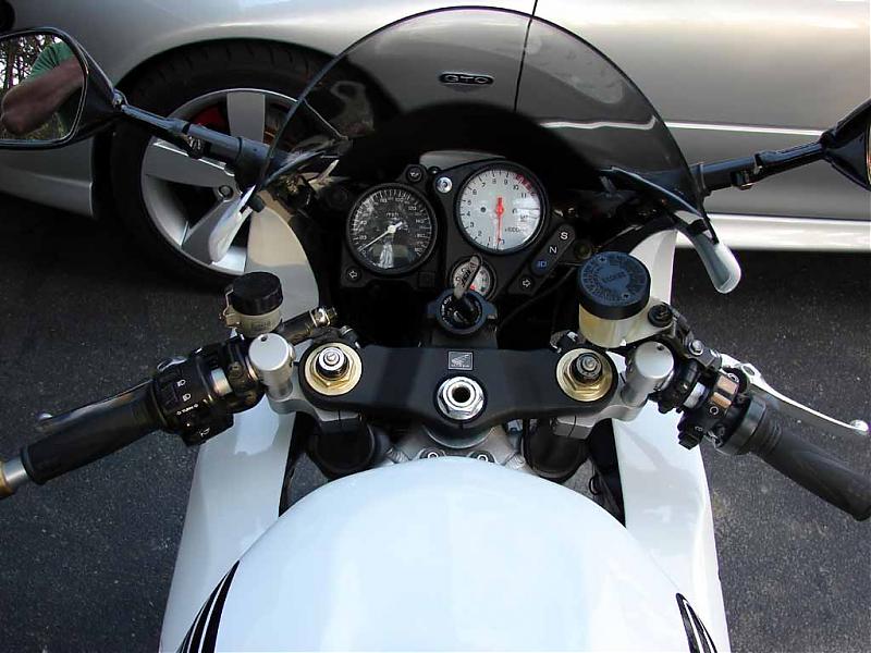

I used risers that bolt to the top triple and installed a cheap bikemaster superbike bend bar. The hard part was making the spacers which allow the risers to bolt up to the triple. They have to be the correct angle for the drop on the gull wing 954 top triple. I made them out of 1.25" (I think) aluminum bar stock with a hacksaw and a file. It took a few hours and they're still not cosmetically perfect, but they work just fine. With better tools they wouldn't be that difficult to make, but I just used what I had on hand.

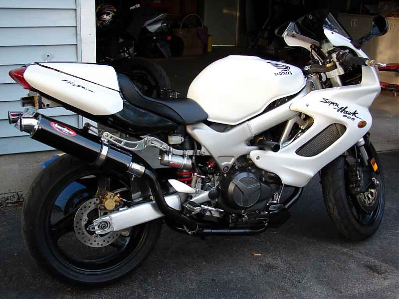

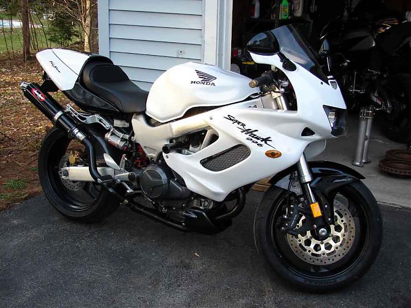

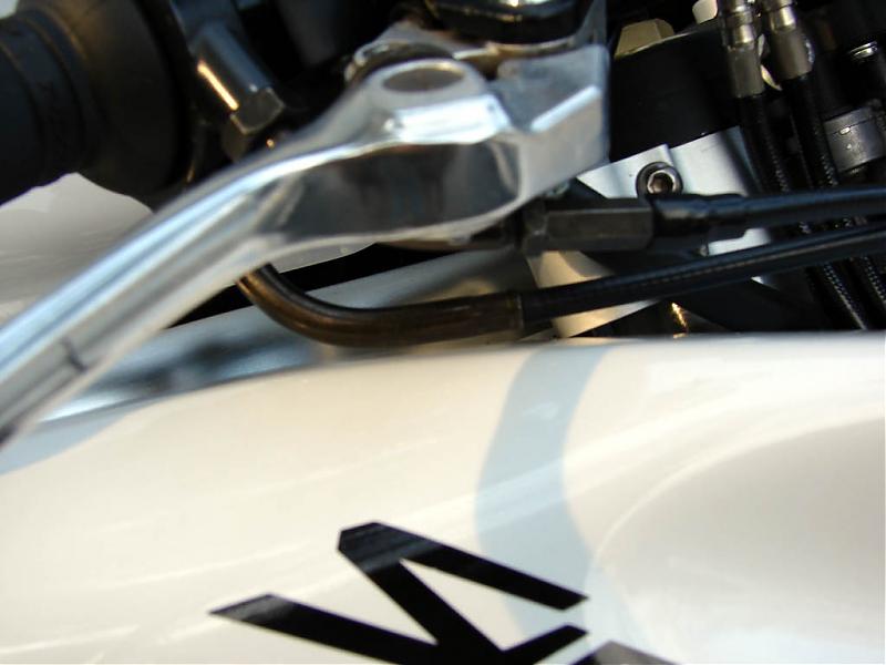

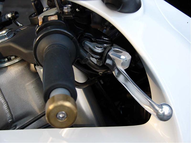

Well, I decided to attempt one last-ditch effort to get these bars right before I dropped $200 for some Convertibars parts. I discovered that just the risers and bars would fit the ScaryFast clamps I already have, so I was ready to jump on the Convertibars bandwagon.
After f*&king with them for about an hour I found that the limiting factor was the front brake master and lever. Now remember I had installed the 929 mc for use with the stock brakes. With the 1000RR radial calipers this was a bit of overkill. There was very little lever travel before I got a rock solid lever. This also led to difficulty in modulation and feel. So I decided to dig the old stocker out of the basement box-o-stock-parts. Everything bolted right up and after a good bleed the lever feel was *just right*! Now, to adjust the bars....
Something I had also noticed about the CrazyFast bars was that they were too wide for my taste. I ended up adjusting everything inwards about 3/4" and that felt much better. Yeah, I have some bare bar showing at the ends but I'll just deal with it for now. If I can sneak them into work I'll get my machinist buddy to cut them down. I was also able to angle the levers down more with the stock master, something I couldn't do due to clearances with the 929 unit. Amazingly everything went very smoothly after that. Clearance are way more than I expected they would be compared to the 929 master.
I was happy about not spending the extra money to get the bars to work. For anyone else doing this project, I think the full Convertibars setup is definitely the way to go. I just got lucky with the ebay special on the CrazyFast bars.
So anyway, after I was all done I decided to clean her up a bit. So here's some pics of the FINAL product (thank God)....

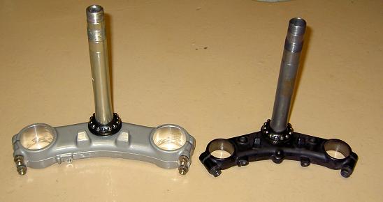

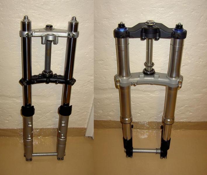

Old Apr 6, 2009 | 01:01 PM
  #77
Here's what the difference in size is...
Attached Thumbnails Yet another fork swap-framgaffel.jpg   Yet another fork swap-styrkrona_undre.jpg
