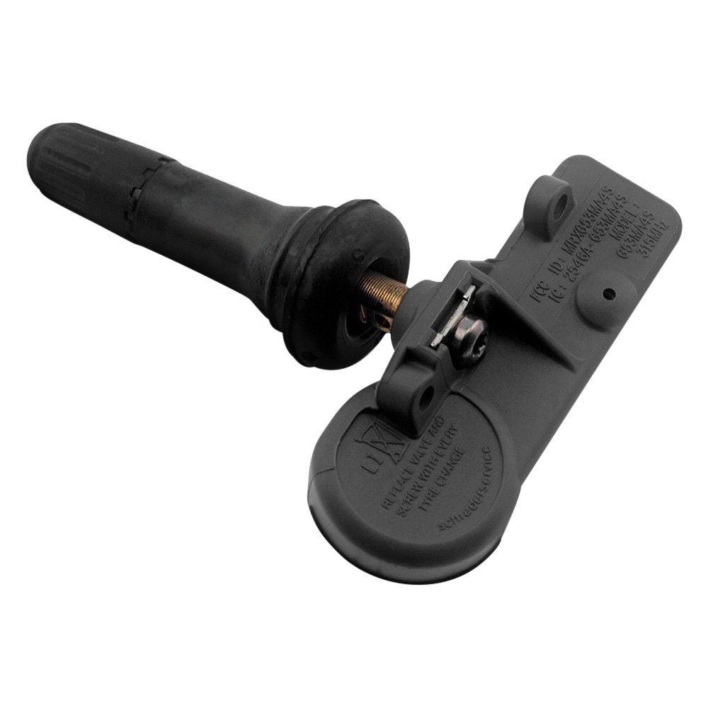

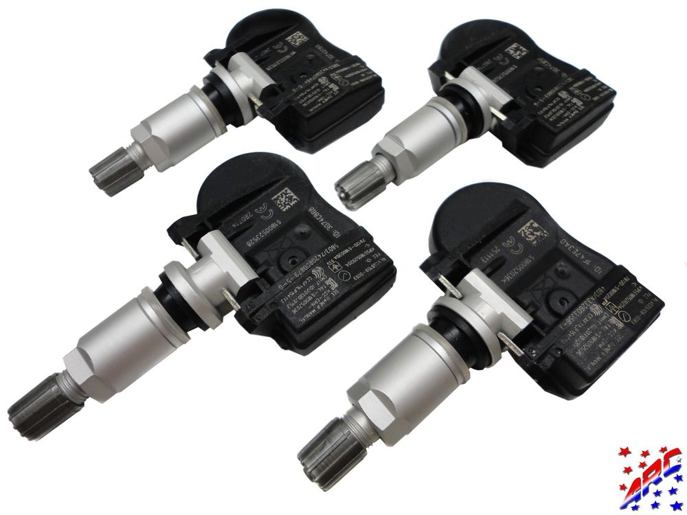

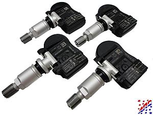

tpms is a great idea and should definitely be on motorcycles.
I had the external type on my ducati 1098. I hated them and the final straw was when I went to the garage to get ready for a ride I saw the rear tire was flat. so I said "what's the point if instead of saving myself bending down to manually check the pressure I have to manually reinflate the tires and check them. they are actually making more work for me". to the garbage they went. as vtr1000f said, the seal is not reliable.
i'd beware the internal tpms with the steel fittings. one on my wife's jeep let go on the highway and things got real exciting real fast. when I went to get a new one the dealer informed me that the steel ones are discontinued because of issues. the replacements are rubber and work well. I have since bought more of the rubber type on ebay(china) for my f150 and they have worked great.
I wonder if there is an app that will work with any tpms sensors...
