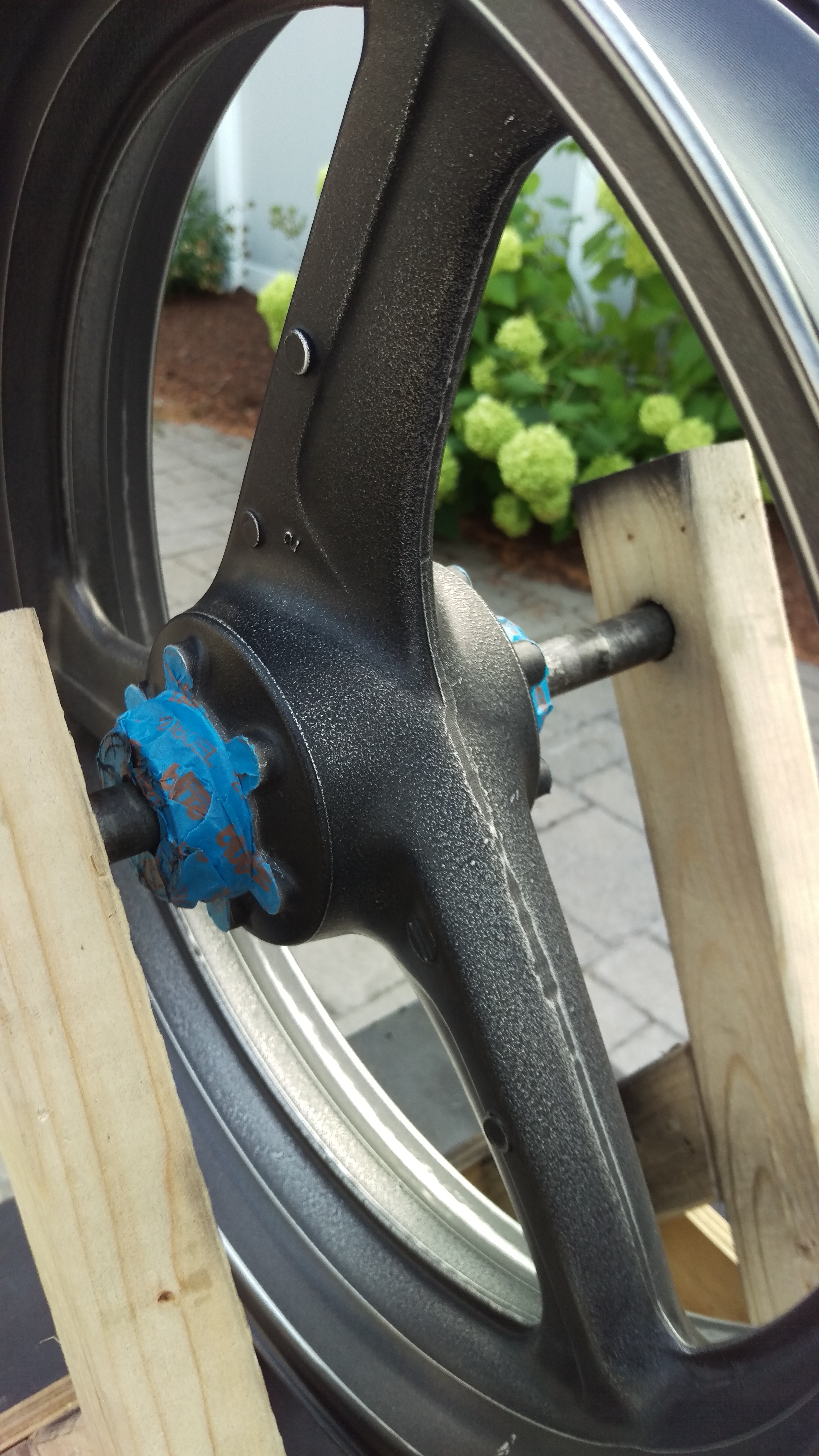

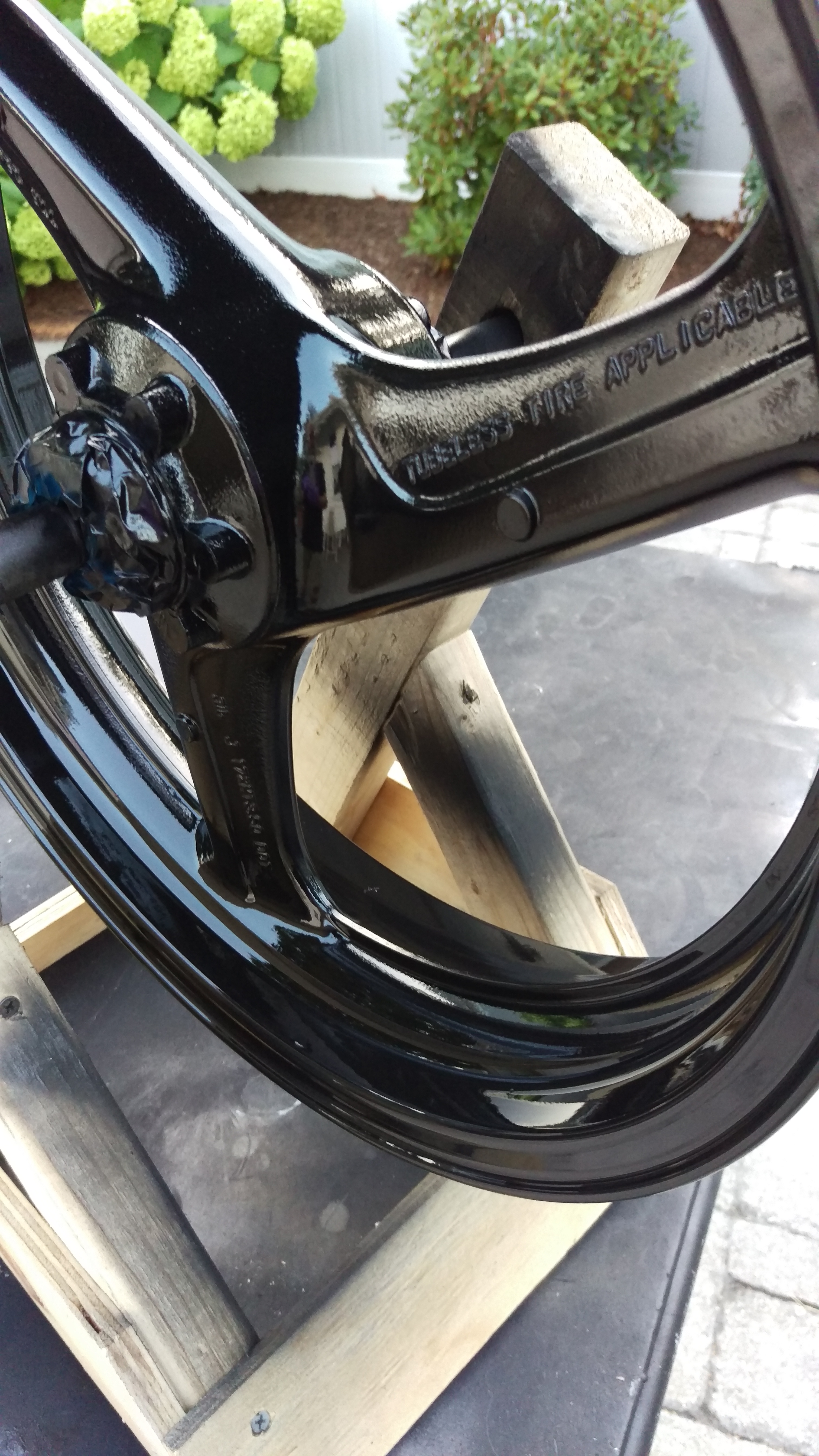

Wheels to go with Tyres
Here are some straight wheels that I purchased on Ebay sanded them and painted them with Duplicolor Wheel paint. All ready for my Pilot CT2.

Old Aug 28, 2018 | 06:40 PM
Posts: 4,517
Gloss black the way God intended and the way they should have come from the factory.

PS. to the Captain....The wheels came out great with the Gloss Black. I made a simple wood frame so I could spin the wheel with a heavy final coat and left it to dry for a week before putting on the new tires.
