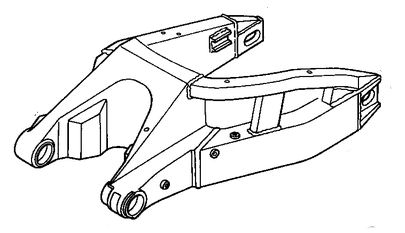

Bike is a 1998 (built Jun 1997) VTR1000F
Donor swing arm is a 94 Honda CBR 900rr
I choose the early year (pre 1998) 900rr because I wanted the brace with the box style front leg. I believe it makes a more stable, better looking swap, then the twin leg version.

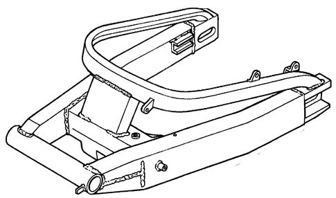

The 1998-1999 CBR 900 rr used the twin leg brace.. and I've seen it work out ok, but the sculpted part needed for clearance near the shock, just never looked right to me.. cept one, and that rider boxed in the two legs with sheet aluminum once they were welded.
The 2000 CBR900rr uses a much different swing arm and the brace is not really useable for this mod.

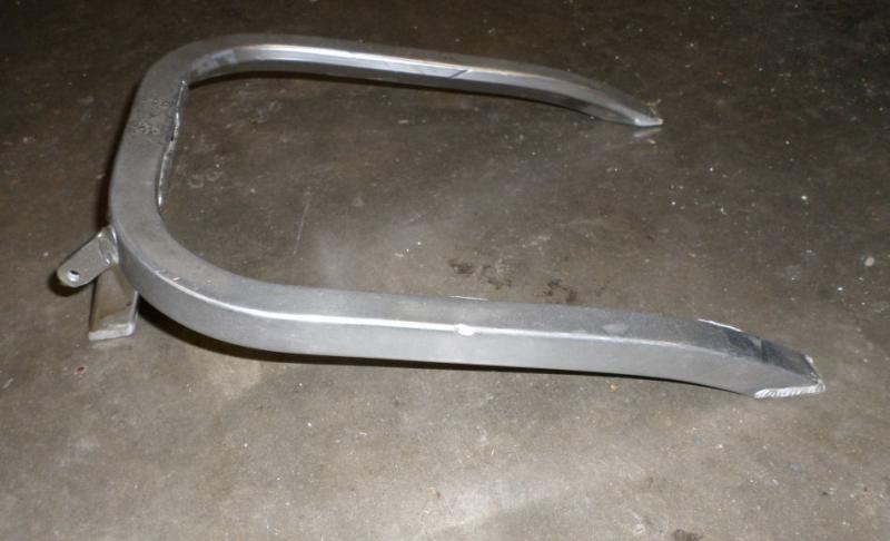

With the donor swingarm in hand, the project started by cutting off the brace
The OEM chain guard tabs were already cut off, so I will just clean up that work and fit a huger chain guard combo.. it does keep chain lube somewhat contained.
As I will be building a under-slung rear brake caliper mount for this MOD, I do not need the 900rr caliper bracket, or the bracket stop from the swing arm.
I will be machining off the OEM caliper bracket stop from the VTR arm as it will no longer be used .
Next step is machining up a caliper bracket strut mount to be welded to the swingarm.
I have ordered materials for the strut, so waiting on those to arrive.
Fitting the brace to the VTR swingarm.. well waiting for that package from the guy in brown....(UPS) on Monday as well.

I don't believe the line drawing above for the 98-99 is accurate. The twin spar versions I've seen (in pics on-line) have the rear side of the spars enclosed. Are there variations of this design, anyone? I agree with the OP that the full box version makes for a cleaner finished install, but I like the twin spar look better. So, I'm torn, but will probably attemp a mod using the later year version 900rr brace. My idea is too cut the backside of the front spars down to allow a smooth blend with the shock cutout on the SH arm at the front of the spar. This would lower the front of the brace a little, but I don't think that would present any problems.

Old Dec 28, 2013 | 09:54 AM
Originally Posted by VTR1000F
I don't believe the line drawing above for the 98-99 is accurate. The twin spar versions I've seen (in pics on-line) have the rear side of the spars enclosed. Are there variations of this design, anyone? I agree with the OP that the full box version makes for a cleaner finished install, but I like the twin spar look better. So, I'm torn, but will probably attemped a mod using the later year version 900rr brace. My idea its too cut the backside of the front spars down to allow a smooth blend with the shock cutout on the SH arm at the front of the spar. This would lower the front of the brace a little, but I don't think that would present any problems.
Erik, are you going to add tabs for swingarm spools?
While it would not surprise me if the lineart is wrong,, it is directly from Mother Honda's OEM parts pages. (I just cut them from the whole pic and removed the other parts of the image)
And yes, I've seen the 99's with the back of the two front legs enclosed.. but others with just the two legs or at least looked that way in the pics I viewed... in any case, I wanted the single boxed front leg, so picked up one of those.
What I did find is a lot of the ebay ads do not correctly identify the year of the swing arm, with many ads showing fitment from 1997 to 2000. .. May be that they all will physically fit, but they are clearly not all the same.
Yes I'll will be welding on tabs for spools
Attached Thumbnails Swingarm brace install + Underslung caliper mount-1999-swingarm.jpg

The boxed braced is also smaller and weeker that's why the other is used mostly .
I have had both braces side by side and the boxed is noticeably smaller .
Define weaker? In what axis? weaker at what?
and smaller in what, material cross section? sq mm of contact surface one design to another? sq mm of surface area the boxed base spans compared to the other twin foot?
And then we have the fact the twin foot version is only partially welded to the swing arm (though, that is on the 900rr, a MOD'er could fully weld it on the VTR swingarm)
Have you seen how many of the twin foot braces are mounted? cutting away much of the footing surface of the right foot base to clear the shock? Some have cut most of the leading part of both twin foot base for fitment.
How did you determine one was "weaker" than the other? destructive testing? Computer aided software failure modeling?
Or was it a Mark I calibrated eye
Not a flame for your opinion.. just really wanting to know how you came to your opinion.
Thanks

Old Dec 28, 2013 | 06:51 PM
Anyone have this version 900rr brace and can measure this?
Better if you can get three measurements for me.. the one depicted above, if you have cut the brace off already, the material thickness (cross section), and the depth of the foot front to rear.
Thanks
Attached Thumbnails Swingarm brace install + Underslung caliper mount-how-wide-foot.jpg
Old Dec 28, 2013 | 09:28 PM
In my estimate any brace is an improvement.
This opinion is not based on fact ,but more on feel having recently used the box brace on my bike it just feels better and more settled on the road.
I also believe that the hawks have a certain amount of flex built into them that does nothing to help the bike when you fettle and improve the suspension and then combine that with the latest tyres that are designed for bikes with stiff chassis dynamics that don't flex like the hawk does.
Thats why I think that any brace will help the Hawk to feel taughter, especialy on undulating surfaces.
Just my 2 cents worth and a very interesting thread.
Please keep us informed of your thoughts and progress.

Sorry I didn't take measurements . The weeker brace was lighter thiner material and had more flex .
If I get time later I will measure the brace requested above

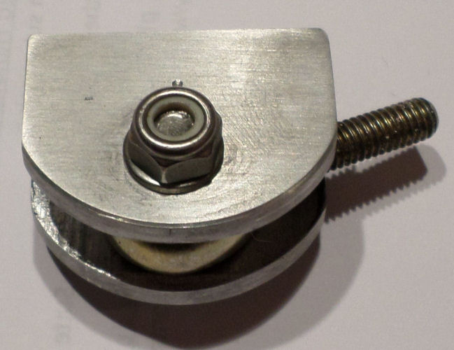

Brake caliper strut mount
Spent some time on the Mil today....
The brake caliper strut mount is done
Milled from 7075 Aluminum
I decided on a captive mount for the Spherical rod end, vice single sided.. Took longer to make, but will provide more strength.
Teflon lined three piece FK Rod end specs at more than 10,027 ftlb Static load... if this application needs more than that... the mount is going to get ripped off the swing arm...
The strut rod will be steel tube with tube ends weld in or 7075 Aluminum round bar... have not yet decided.
Attached Thumbnails Swingarm brace install + Underslung caliper mount-brake-strut-mount-bottom.jpg   Swingarm brace install + Underslung caliper mount-brake-strut-mount-front.jpg   Swingarm brace install + Underslung caliper mount-brake-strut-mount-back.jpg

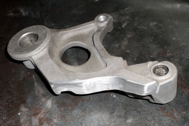

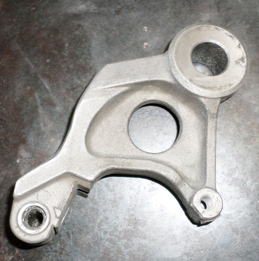

Cut the VTR caliper bracket down last night and did a little bit of finish work.
Realized doing it this way, besides having to remove the caliper to bleed, it will require a new brake line. Another $50 to the mod...
If Im spending another $50..... perhaps scrap this plan and go with a proper caliper to start with...
Thinking> Garage > 3rd beer = Bad idea
Fresh at it this morning and after some research... I think a rather common GSX1300R rear caliper and bracket may be a better option.
Buy in will be $60 or so, but I can re use the SS line I already have saving a bit.
The Hayabusa rear axle is 25mm dia, vs our 20mm.. but that is just making a simple bushing to correct. If the alignment of the Busa caliper and bracket is not good for the VTR, I can fix that by milling the Busa bracket, and or building a spacer as part of the bushing to get proper alignment.
The last concern is the distance from axle center to caliper pad swept surface area..
The Busa uses a 240mm disk
The VTR a 220mm disk
So 10mm difference in radius
I think this last point is pretty big, and makes the GSX1300 caliper bracket unusable... unless I buy a 240mm disk.... which adds cost and rotating mass I don't want.. Worse is I just bought a brand new 220mm Galfer wave rotor for the VTR...
Thoughts?

Old Dec 30, 2013 | 08:08 AM
I wonder if there's any way to get a Busa disc to fit?
Or if you can get VTR pads on the Busa caliper and locate it in a way that the radius matches....
Old Dec 30, 2013 | 08:26 AM
Posts: 2,098
Can you find an under slung caliper that's a bolt-on for the VTR bracket? Seems like a longshot, but...
Old Dec 30, 2013 | 08:33 AM
Finding a 240mm disc that fits the VTR wheel is not hard.. heck I could even cut down a larger one if needed and all i could find to fit the wheel..
It's just another part, more cost. Which I would like to avoid.
Hmmmm, perhaps an off set bushing for the busa bracket.
I could bore the 20mm hole in the 25mm bushing off set...that could account for about 4mm. Leaving me 6mm difference
Old Dec 30, 2013 | 08:38 AM
Have not yet... and truly.. Im about ready to just get a caliper designed for under the swing arm, and machine up a bracket from scratch...
Crap load of work on a limited capacity manual mil.... and the material would be pricey ... plus one slip of a tool... wrong turn of a carriage hand wheel..and you turn a $$ Al billet into scrap

Hey, if using the VTR caliper and modified bracket, couldn't you just disconnect the strut and rotate the assembly upright to bleed the rear?
Old Dec 30, 2013 | 01:39 PM
I don't know about you guys but when I do mods I get impatient and just want to get it done.
In this case I found it easy to follow the tried and proven method of using the 900RR caliper bracket but I don't like the look of it.
The effort required to undersling the caliper is worth it in my opinion as it gives the bike a totally different personalised look.
Of course cost is a consideration, and as I still wanted to ride my bike I had to purchase 2 used swingarms and a caliper bracket, then weld and paint, as well as buy a hugger.
My all up cost was approx $450- Oz and then there was my time as well.
Looking forward to the finished item
God knows what all this would cost if you got a custom builder to do it!!!
