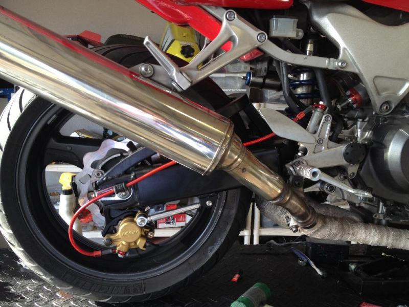

Can I post a picture of my RR swingarm brace mod with RR caliper mount?
James
Of course

A few of my swingarm pics... Sometimes I just sit in the garage and stare at it.... Makes me smile
James
Attached Thumbnails Swingarm brace install + Underslung caliper mount-img_5460.jpg   Swingarm brace install + Underslung caliper mount-img_5478.jpg   Swingarm brace install + Underslung caliper mount-img_5479.jpg
Old Jan 23, 2014 | 06:38 PM
  #63
James
Except for the color and location of the caliber, we have the same set up

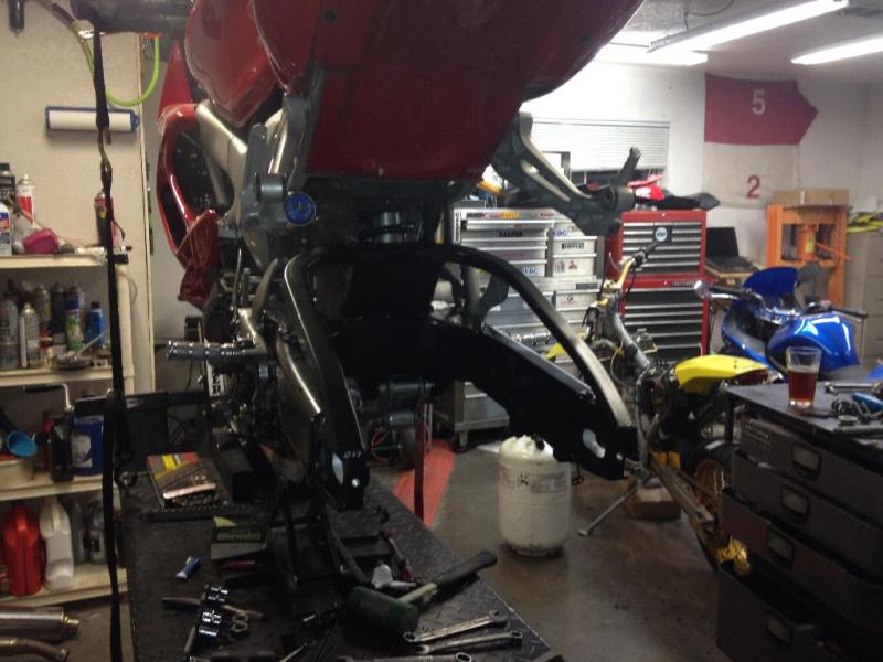

Old Jan 27, 2014 | 04:57 AM
  #81
Coming along nicely
Got done with class yesterday and picked up my freshly powder coated parts.
Just had to get started on installing them..

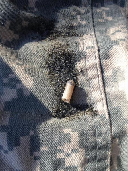

First up was cleaning the stray blast media out of the swing arm...
Had two or three piles about that big... Id have preferred the coater do that before spraying.. but as all the bolt holes and such are plugged with silicone plugs or taped over... the media INSIDE the part does not really effect a clean job on coating.
Then initial fitment check
And one last one at the stopping point for the night
Made a bone head move,, and forgot to order a new rivet style chain master link,,, and fitting a endless chain in and through a swing arm with a brace is a bit tough
But I'll get things buttoned up today and have the wife bring one home from work on Tuesday.
Attached Thumbnails Swingarm brace install + Underslung caliper mount-6104dc30-5e3a-452d-91b4-4b599fda13c0_zpsvuhrzrjg%5B1%5D.jpg   Swingarm brace install + Underslung caliper mount-13359925-40c9-4ffb-b880-278524b17da7_zpsszndui2f%5B1%5D.jpg   Swingarm brace install + Underslung caliper mount-d735989d-051e-4b89-920b-8d584ab6b58e_zpsjcbtbqeg%5B1%5D.jpg   Swingarm brace install + Underslung caliper mount-62a7e5a9-c362-48b8-a9b8-9820f353c72e_zps5agkmtwu%5B1%5D.jpg   Swingarm brace install + Underslung caliper mount-fc38d17a-3596-48e2-b82f-f670631678ad_zps8zenayag%5B1%5D.jpg

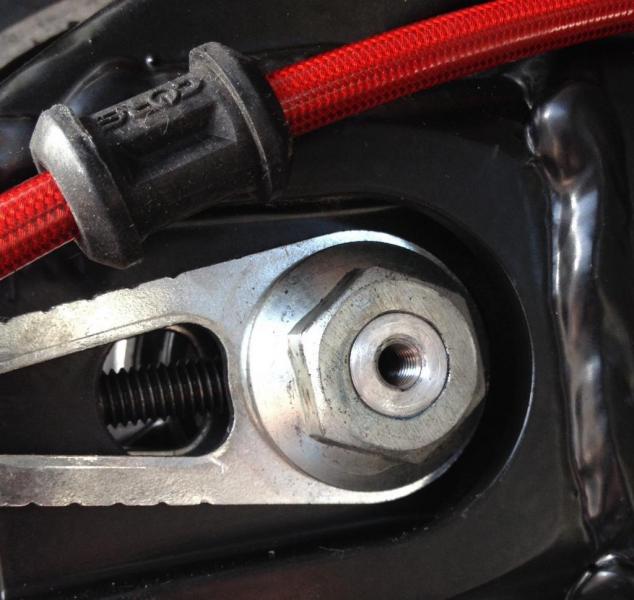

Old Jan 29, 2014 | 07:44 PM
  #87
Been puzzling over brake line routing and attachment points.
Did not like the white plastic clamps, and needed a second point more rearward than the factory location.
Decided on routing the line along the OEM route.. top of the swing arm, using the original forward swing arm point with a different clamp.
And then using the hollow center of the axle for a second attachment point.
Machined a bushing from 6061, threaded it and installed a Stainless steel thread insert for M6x1.0
Pressed into place and used some loctite retainer compound to help keep it there.
Button head socket screw in m6 x1.0 plus a back clamp finished it off
Not completely happy with it, but it'll do for now.
Removed the caliper, got the bleeder positioned at the top, and bleed the MC, banjo bolts, and then the caliper..... aided by the old rear disk stuffed in the pads to maintain brake pad position.. it was a quick work.
Attached Thumbnails Swingarm brace install + Underslung caliper mount-fc38d17a-3596-48e2-b82f-f670631678ad_zps8zenayag%5B2%5D.jpg   Swingarm brace install + Underslung caliper mount-81059d28-18d4-4d34-a835-8129a93f7976_zpsft7ouyxy%5B1%5D.jpg   Swingarm brace install + Underslung caliper mount-71c05ed1-b1ca-4d4f-a688-b64df23028fa_zpsonlvxbep%5B1%5D.jpg   Swingarm brace install + Underslung caliper mount-e1e79d16-5379-43cb-b169-bc79d74388a7_zpst00xihg3%5B1%5D.jpg

Old Jan 30, 2014 | 05:31 AM
  #89
Originally Posted by CruxGNZ
It looks good. Nice work fabing up that mount inside the axle. I thought you were going to hide most of the brake line, because in your previous pictures, it looked like there was a couple grommets on the brake line for running it through the brace or swingarm. Now I see what those rubber pieces were for. Still, it looks good.
Thank you..
The grommets are added when you have the line made.. CORE MOTO will add as many as you request based on your needs.
They are silicone and designed to protect the line when clamped.
I would not think boring holes in the swingarm or brace that are big enough to run a 10mm banjo fitting though, or even just the line and a grommet for protection is a good idea for structural integrity. Computer aided design and non destructive computer aided testing might show ways to do it.... but I don't have that capability.
Im sure guys with show bikes, or just no concern for structural integrity have done such.. to obtain the cleanest look...
But this project was to find the balance of both function and THEN a good look.
Another guy I know that did a similar mod.. ran the line under the swing arm...
But I do not like that tight bend on the far end of the line and the strain it places on the fitting/line connection.
The end game is a different caliper ... one that has the bleeder and in port on the top... so will save line revisions for that change.
Attached Thumbnails Swingarm brace install + Underslung caliper mount-under-slung-caliper.jpg
