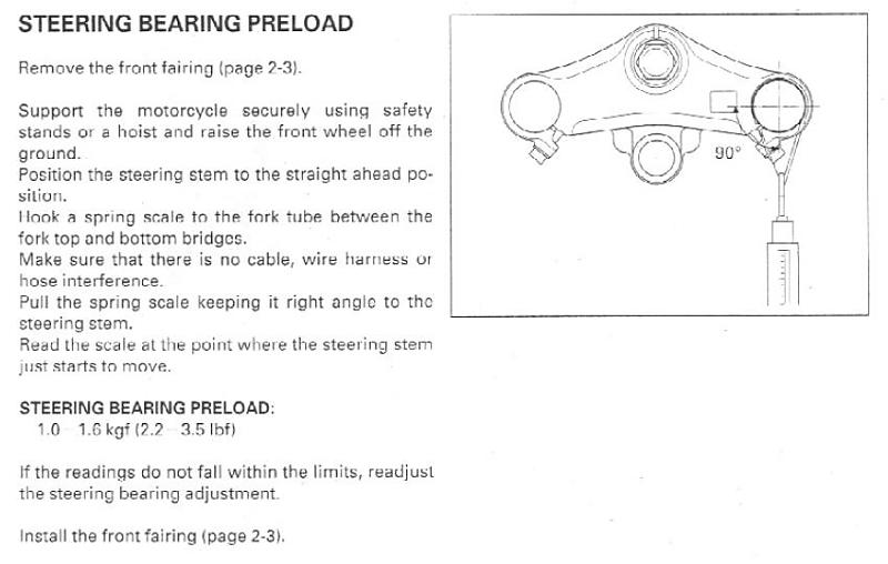

Old Apr 18, 2008 | 08:20 PM
You need to tighten them more. It's a fine line between too loose and too tight, especially with tapered rollers. There is actually a specification for it - something like 3lbs using a spring weight, you know, one of those things they use to weigh fish with.
...here it is....
Attached Thumbnails Steerring head bearings for front end swap-bearing-preload.jpg
...here it is....
I have tried just tightening them, and not had the desired result.
I'll have to take another look.
Thanks for the photo.
