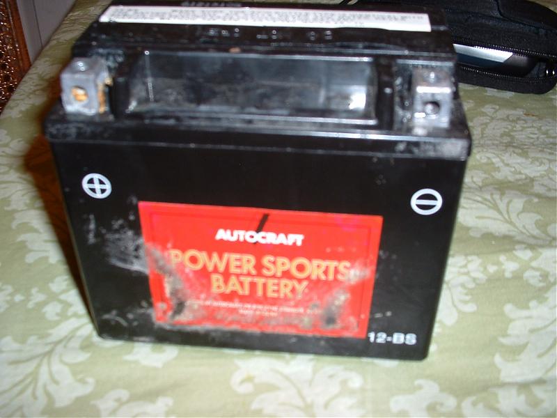

Post a photo of your battery so we know exactly what type your using.
Worst case scenario is you may have to purchase a new battery(due to improper charging method) and a new voltage regulator(cause hey, they just go bad). Most of us had to do this already. If not, put it in your budget for down the road.

bought at advance .

You buy the cheap battery at walmart or adv auto and you're bound to get what you pay for. I reccomend the sealed Yuasu-

OK, you have a sealed-type battery going by the photo. Just a lesser quality compared to a Yuasa. Not that that one won't work, but you should have 12.2-13 volts of charge on it just sitting there. If you don't, go get a Yuasa battery. Treat yourself to a good battery and spend more time riding.
+1
And a Battery Tender makes a world of difference too.
