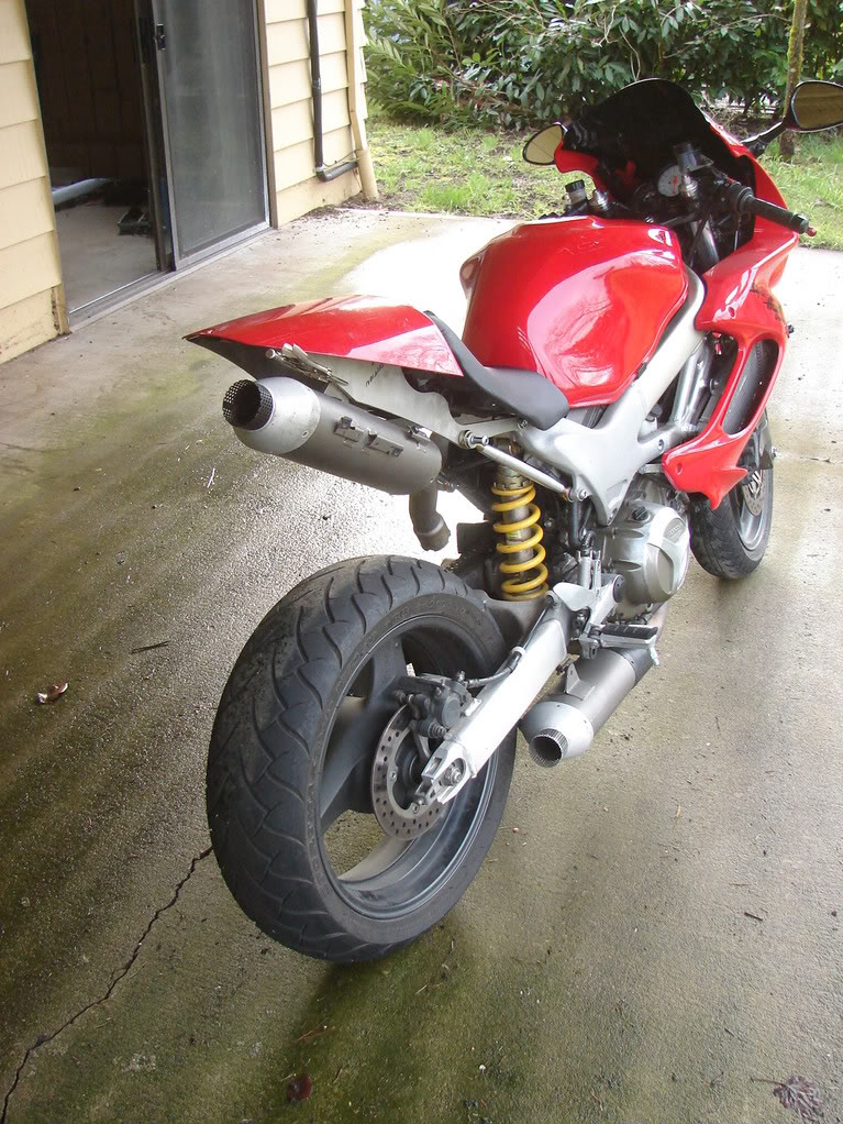

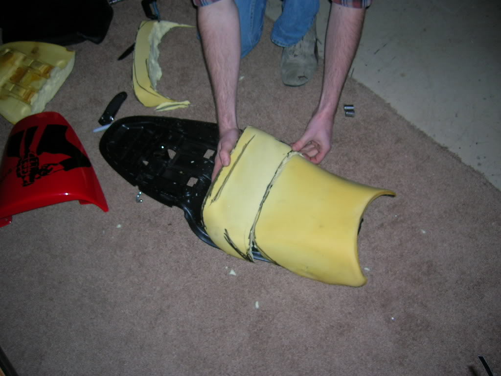

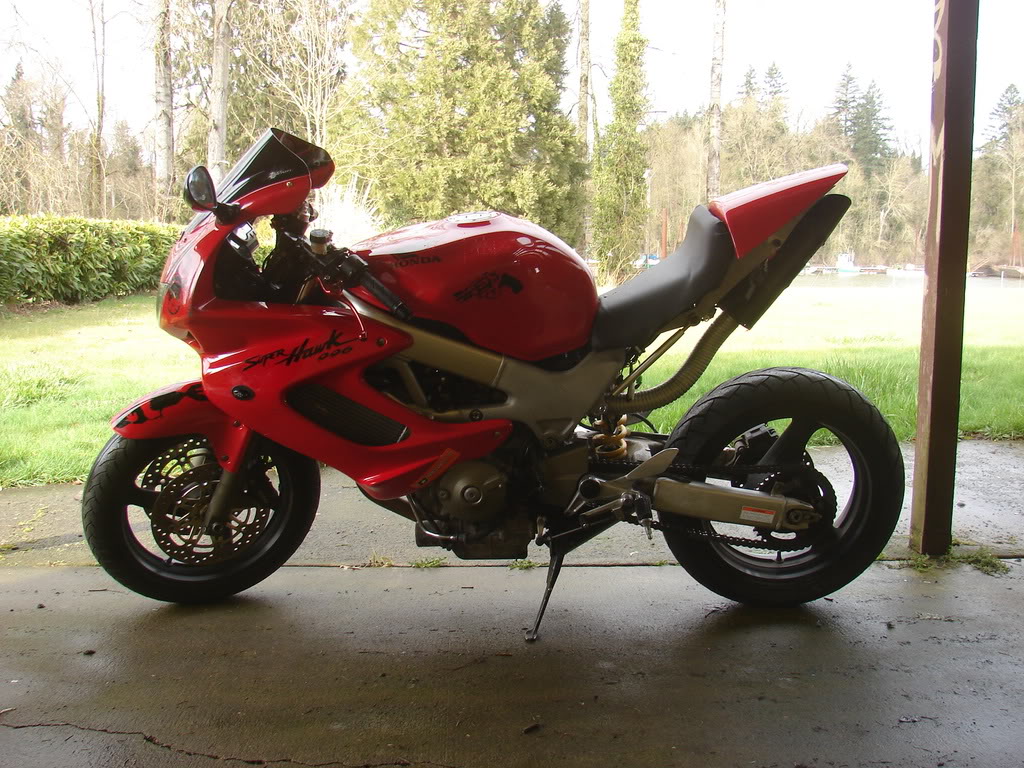

ok new to this forum thought i'd put up some pics about my current project i'm about 80% done i should be done in about a week's time
designed framerail's and made linkage have can's working on undertail and underbody exhaust also egr removal might want some input on that part

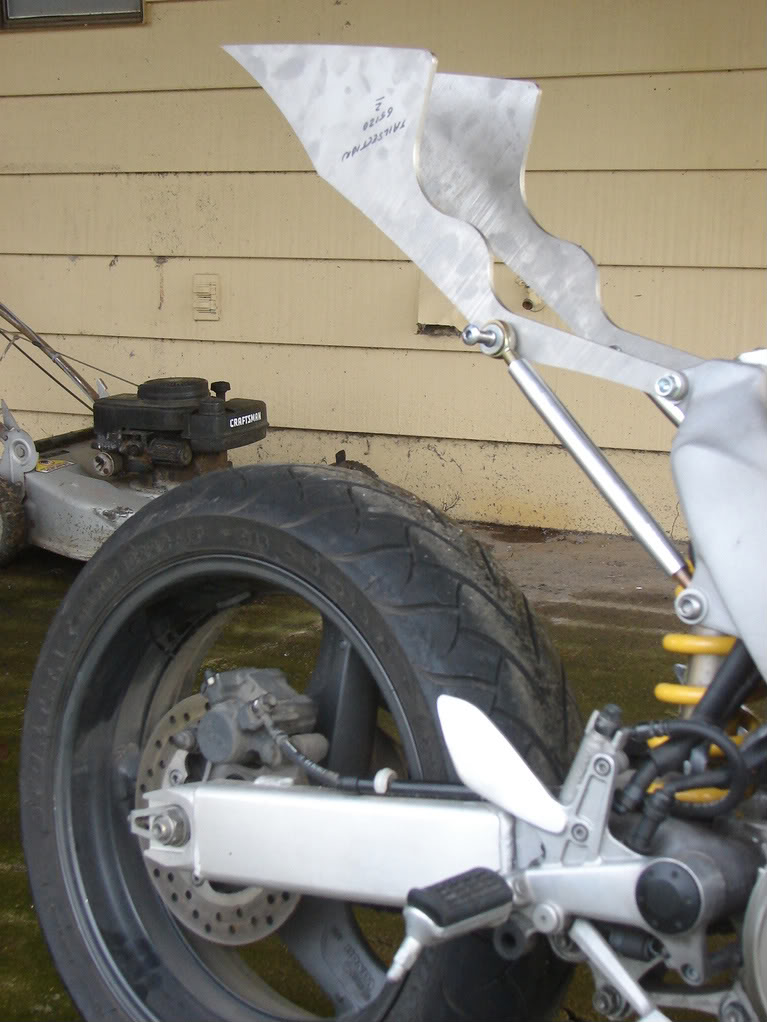

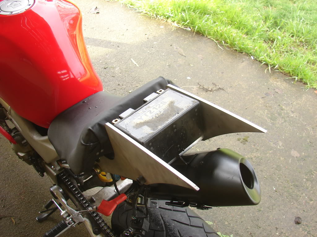

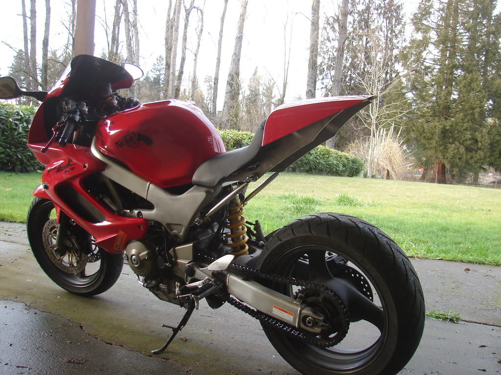

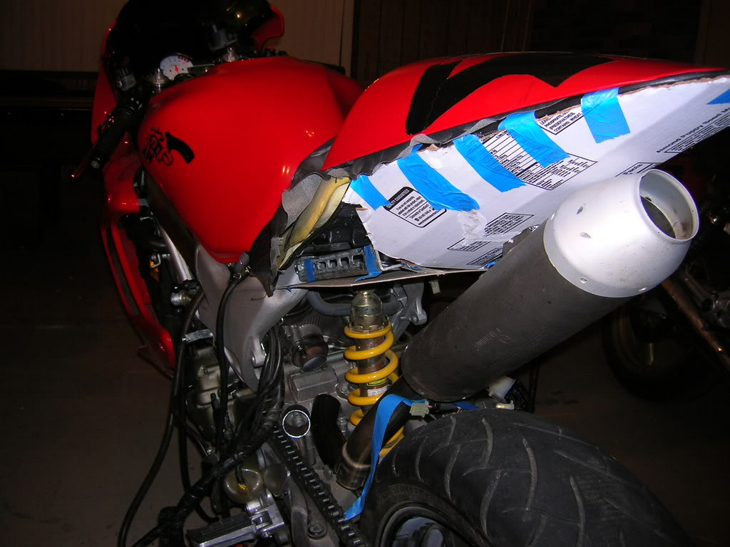

got egr block off done i will try and do a write up with some instruction's if i get a chance frame rail's are made of 1/4 in stainless and i made the aluminum links out of .75dia aluminum i have ball joint's linking it together
exhaust is getting painted then welded to flexible exhaust so i can raise and lower the tail to whatever angle i want i will wrap the flexible exhaust in heat tape let me know if anyone has any suggestion's

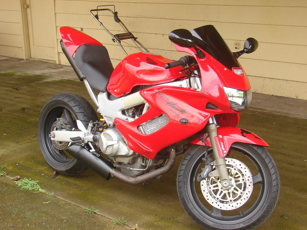

Welcome aboard. The project looks good. Could you get bigger pics up though? Its hard to see the detail. photobucket.com works for me. Then just paste the IMG code and you get big pics.
The only suggestion I have is to angle the lower pipe up for a more MotoGP look versus drag bike look.

May I ask how the rear suspension is going to compress? There's surely not enough clearance there between the tire and the exhaust.

Just had an idea. You are obviously trying to do something completely different from anything that has ever been done. Have you ever condsidered dual undertail exhuast like the 06-07 ZX10R has or the 6th Gen VFR? That would eliminate the wheel clearance issue.

ok so the way i designed the rear of this bike i have adjustable linkage with the ball joint's whick allow's me around 90 degrees of adjustability on the seat so i can raise the tail as high or as low as i want and the exhaust which i know you were going to ask about next i made it with flexible exhaust tube and linked to the undertail so it moves with the seat
i like the look of one down low and thank's for the suggestion i'm gonna angle the bottom one up moto gt style getting it welded the rest of the way this weekend will keep you posted

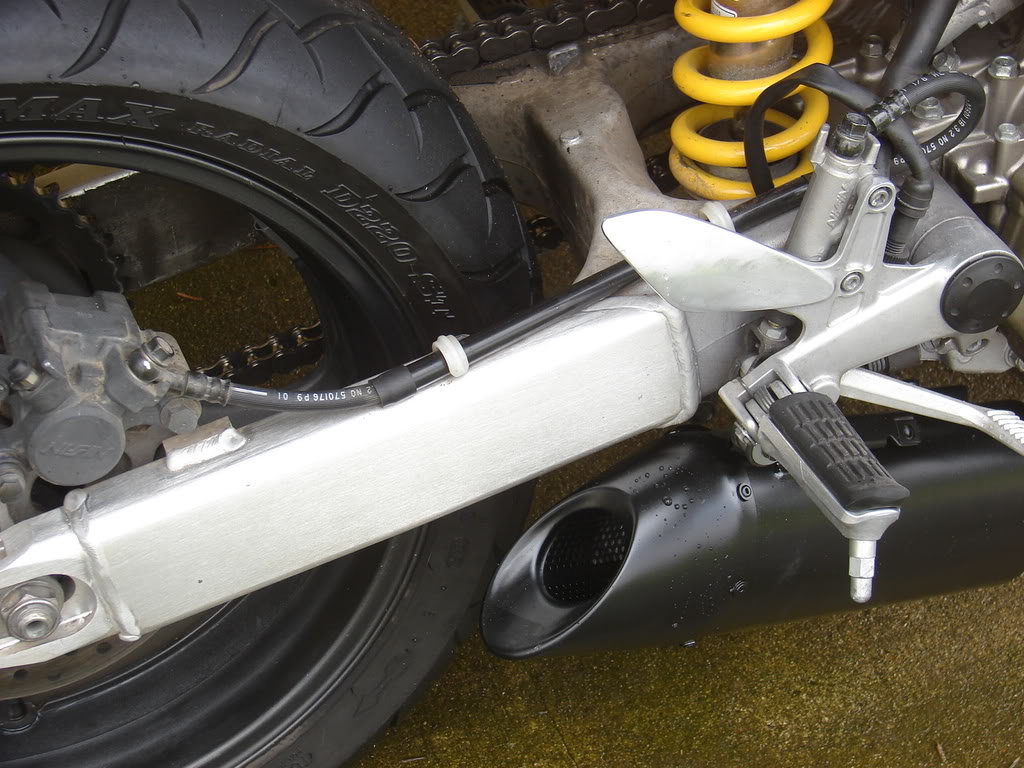

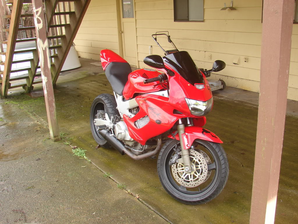

found some new exhaust tip's i like better so i had to do a little switch up

still having some trouble hidding all the comp chip's and making look good but maybe thats just cuz i'm being a little too ****
